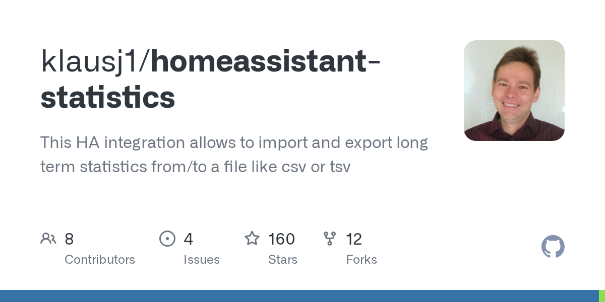

I don't have the details handy but there is a github repo import_statistics which exports & imports csv data for HA. There is also a thread on this in the community.

I've seen a few similar threads on this. Eg
Since there are some people who think this is a good idea, why not share what you have done. It could help others and if enough people think it is good it might even get official support at some point.
I had to fix some long term data and my sql skills are lacking. So i used this to export, tidy up, and then import. It would work also for just importing new data.
