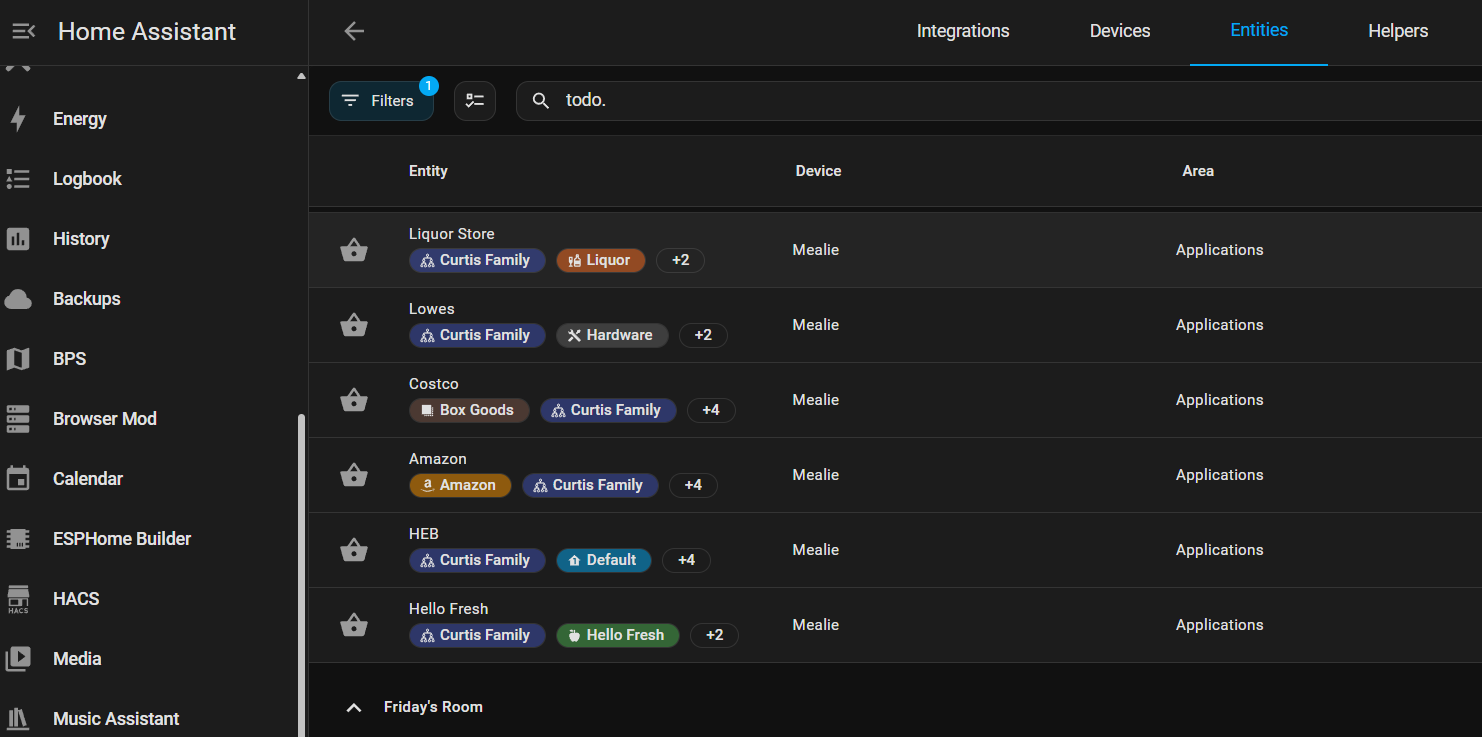

Does this help?
It’s the entities list - filter for todo. at the top (todo domain ents)
Click any one of them:

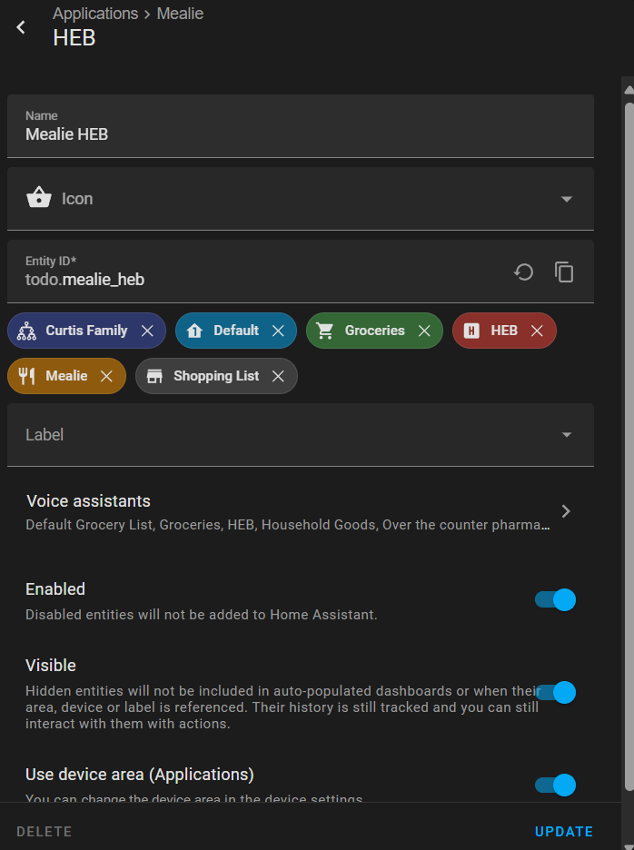

Gear Icon:

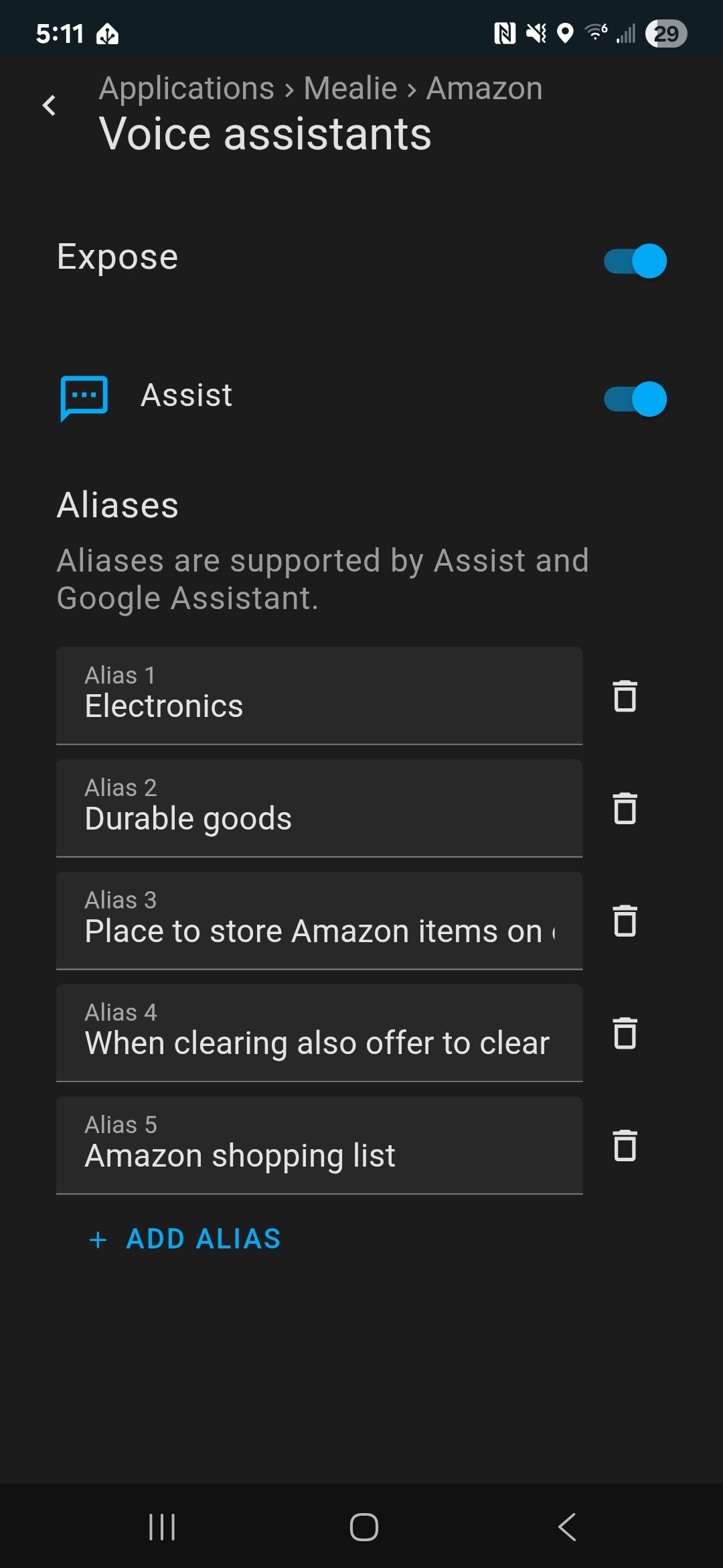

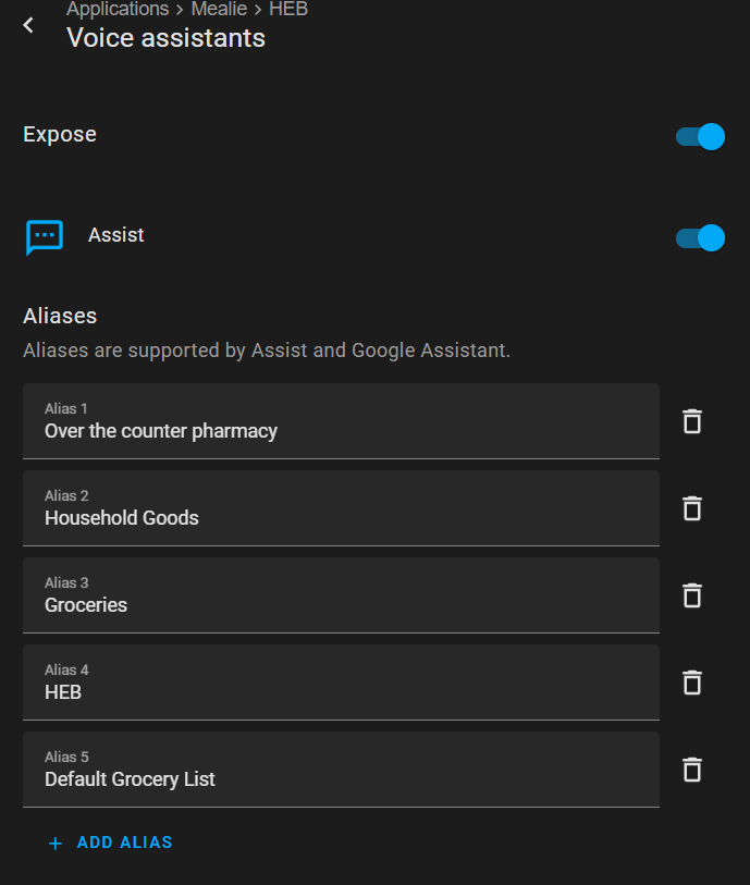

Voice Assistants:
These will offer context for LLMs and if you keep them short words should also offer aliases that might patch. If you’re using short phrase for language over LLM - keep these as short words or simple one or two word phrases. If you’re using LLM be VERY descriptive. In my example Im using LLMs so I’m being descriptive.
Yes. By the current definition, Aliases are alternative names used only to refer to an entity, area, or floor… they aren’t available for the items you put on your shopping lists.
