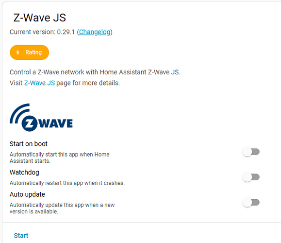

Hello all. Somewhere during my initial setup, when I had no idea what I was doing, I somehow installed Zwave JS and Zwave JS UI. However, Zwave JS has never been started or used as shown in the below screen shot. Is is safe to remove the unused application without breaking anything in the Zwave JS UI setup? Or should i just leave it as is, turned off?
It seems like leaving both will cause a problem one day, but removing one may cause a problem today :grinning: I have so many Z Wave devices and entities now that it would take days to reconfigure everything. Thank you.
I removed Zwave JS a few days ago and had no adverse consequences.

removing should not be an problem.
Step 1 and always great practice, create automated (at least) daily backups and create a new Backup the moment before you make any big changes (just in case/insurance).
I just did backed up HA, performed a few updates and uninstalled ZWJS and all went well. I know I will eventually migrate back to ZWJS core, but I don’t have the time right now should something go wrong. I will bookmark the link provided above for that project.
