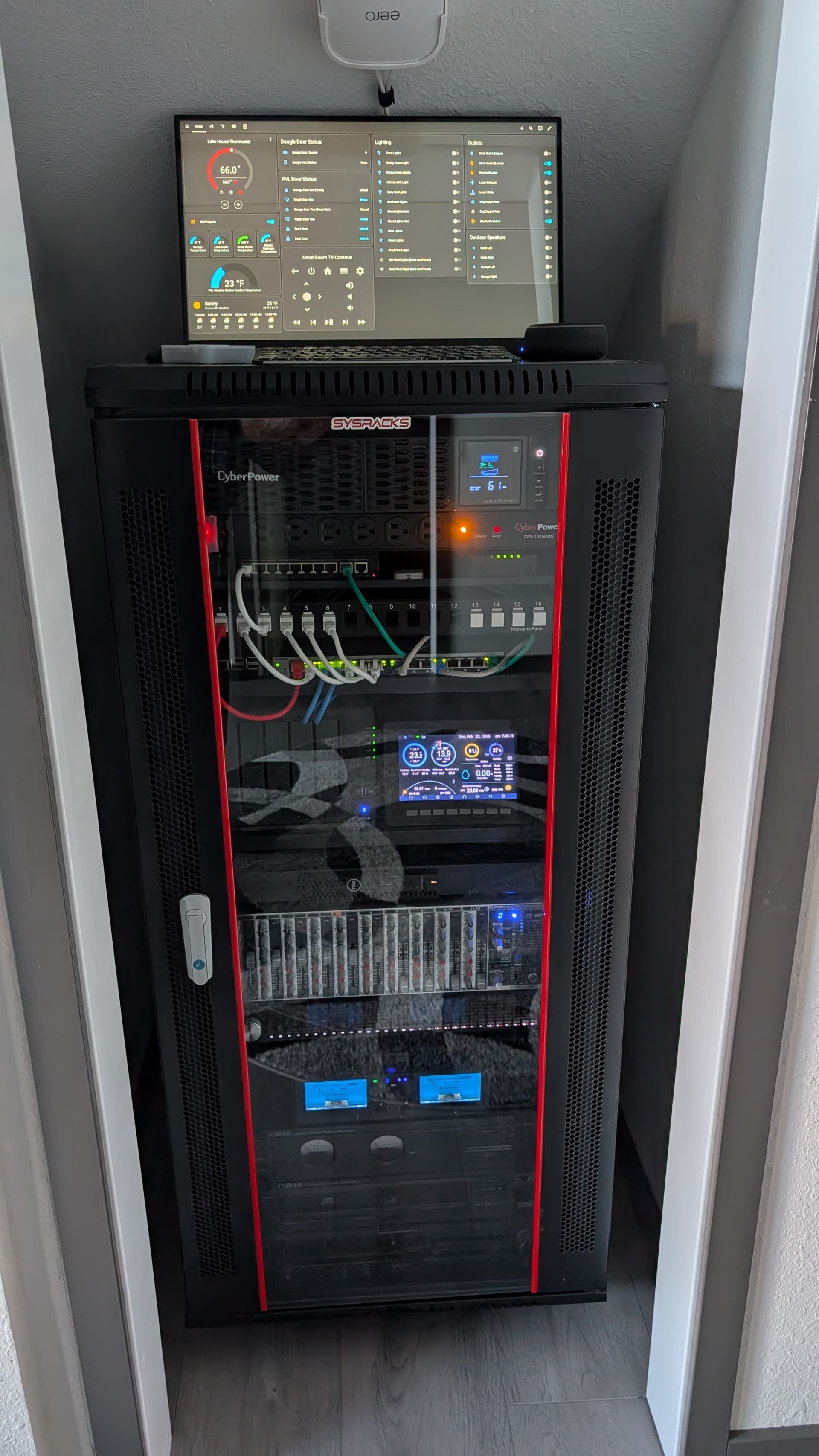

Regarding your item 6… under the staircase was my solution as well. There happened to be another coat closet less than 10 feet away anyhow.
Inside the rack I have a UPS in the top, followed by a couple of generic switches, a patch panel, another switch, my Synology NAS, my weather station display, a rack mounted Dell PC (running HAOS), my audio mixer, a Bluetooth unit, an audio amplifier, followed by my Carver Stereo gear.
On top of everything is my eero router, a 22" Touch Screen and wireless keyboard (running on the HAOS PC below) an Echo Dot and my HA Voice Preview Edition (being fed into the audio mixer below).
You can never have too much rack space… you’ll find something to put there, trust me.
