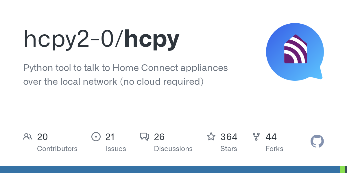

There is an HACS integration with local control for Bosch Home Connect devices.
Am I mistaken but this seems like a read only solution, meaning that HCPY can only read the status of the appliance and not actually control it.
I could be wrong but it’s listed under the starting programme part?
I’m not actually using the integrations to start my dishwasher. I have a fixed 2-5am slot with cheaper electricity, configured that slot in the Home Connect app, and when I turn the dishwasher on it automatically delays the start until that time.
I haven’t been able to find great examples of how to use the HCPY integration so a lot of my automations have been created via tinkering and trial and error. I was finally successful in setting up an Aqara zigbee button that toggles an input boolean for a dishwasher delay setting, and then another automation that actually starts the dishwasher at 2:00 am if the “dishwasher delay” input boolean is set to true.
My automation to actually set it to run sets the ActiveProgram for the dishwasher, then uses a button press to press the ResumeProgram button for the dishwasher. It has worked without fail for a few months for me. Let me know if I can help with any details about how I have it set up.
