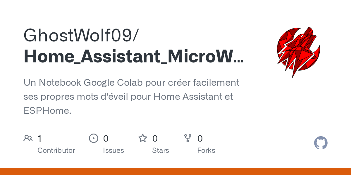

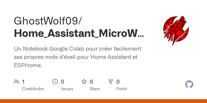

Hi, I had the same problem. I just finished an updated version of a Google Colab notebook for microWakeWord. I did quite a bit of testing with Piper and a French voice, but in the end, I stuck with a version where I simply recorded my own voice and my family’s voices using my smartphone. I did use Piper to generate the negative samples. I’m pretty happy with the result, though I’ll see how it holds up over time. Feel free to let me know if I can help with the Colab notebook.
