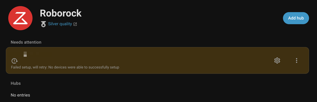

Is Roborock still not working with 2025.12.4?
So I upgraded to 2025.12.4 and I was hoping the issues with Roborock would be resolved, but it seems they haven’t.
And then I read this note on the integration’s website
And I was wondering if this was always the case. Because my Q5 Pro used to work just fine with Home Assistant.
Can anyone shed some light if the ~Roborock integration will/can ever be fixed, or if there are any alternatives to use my Q5 Pro with Home Assistant?
Thanks

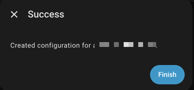

Finally! Made it work!!!
Been tinkering with gemini and when succeeded, asked to made a guide
Enabling Support for Roborock Q10 S5+ in Home Assistant
The Roborock Q10 S5+ (B01-Q10 series) is currently not fully supported by the official Roborock integration. If you add it, it will either fail to initialize or show no battery and a fixed “Idle” state.
This guide explains how to create a patched Custom Component to make it 100% functional.

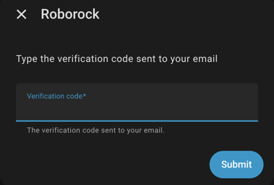

Add the Roborock integration (it will now use your custom_component version).
Login with your Roborock account.
The Q10 S5+ should now correctly report battery percentage, switch to “Cleaning” status when active, and respond to all controls.
