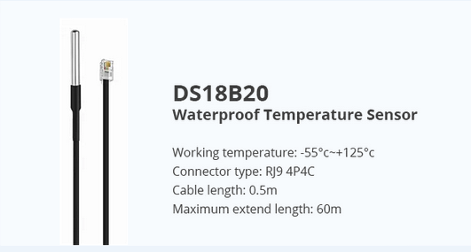

Get a sonoff TH elite and their waterproof temp sensor.
It is rated at 20A so should also be able to easily handle a fridge and freezer starting up.

I need it in my fridge :slight_smile: and the plug is outside, on the wall, unless there is some kind of probe that I can run through the door to get the inside temperature?
Not sure how to make it go to the inside of the fridge without creating a gap in the door seal.

So I’m thinking of another temperature sensor for the freezer part and use both combined to define when to off/on the plug. But that one needs to go down to -18°C or sometimes -24°C.
