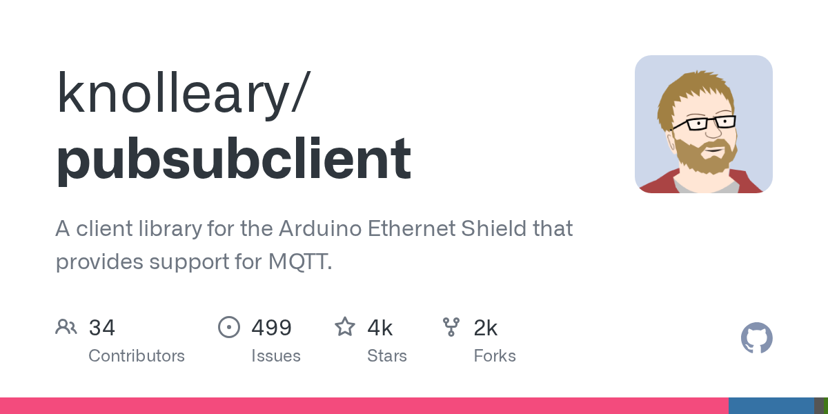

This one?
Last update a few years ago? Either very stable and doesn’t need any bug fixes, or abandoned.
