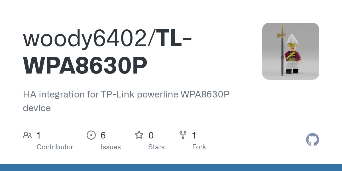

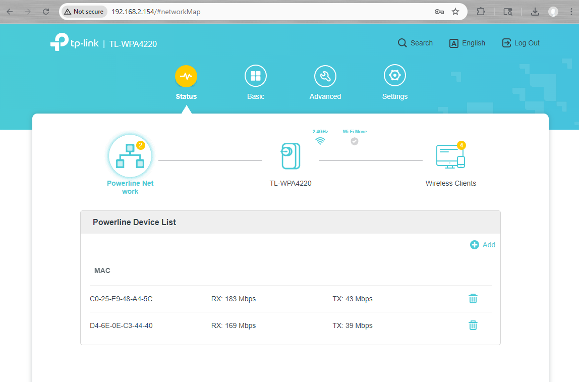

HA Integration: working for WPA8630P, WPA8631P, should for WPA4220

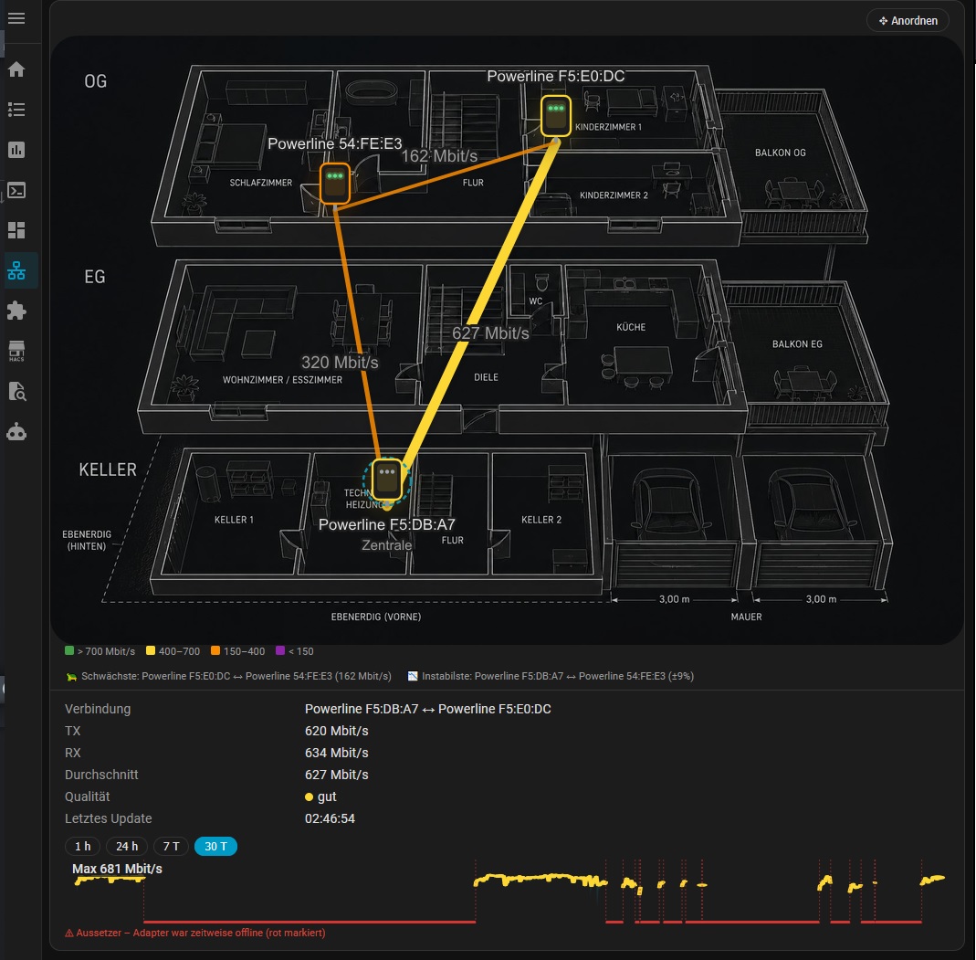

:white_check_mark: Real solution found: ha-powerline Integration (Layer 2, no IP needed)
Hi everyone,
I was looking for exactly this for a long time — and it finally exists!
There is a great new HACS integration called ha-powerline that solves the problem for many of us:
It communicates directly with Powerline adapters via raw Layer 2 Ethernet (just like the official tpPLC app), no IP address or web UI required.
Features:
  • Automatic discovery of adapters (TP-Link, FRITZ!Powerline, devolo, etc.)
  • Real-time TX/RX PHY rates (both directions)
  • Turn LEDs on/off
  • Power Saving (standby) control
  • QoS priority selection (Internet / Gaming / Audio-Video / VoIP)
  • Beautiful live topology graph with link quality colors, rate history, sparkline, outages detection and smart alerts
Repository: GitHub - Chance-Konstruktion/ha-powerline: HACS integration for Powerline adapters — compatible with standalone PLC adapters, no WiFi or IP address required! · GitHub
Installation: HACS → Custom repositories → Chance-Konstruktion/ha-powerline (category: Integration)
Requirements: Wired Ethernet connection to at least one adapter + CAP_NET_RAW capability.
It works very well with:
  • TP-Link AV1000 (TL-PA7017)
  • Qualcomm AV500 class adapters
  • FRITZ!Powerline (AVM)
After installing it I was finally able to uninstall tpPLC and the FRITZ!Powerline app from my PC (except for initial pairing or firmware updates).
Highly recommended if you have “invisible” pure PLC adapters.
