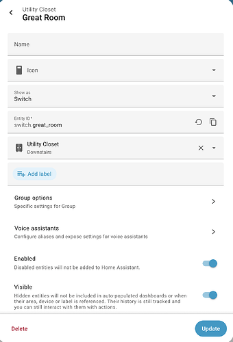

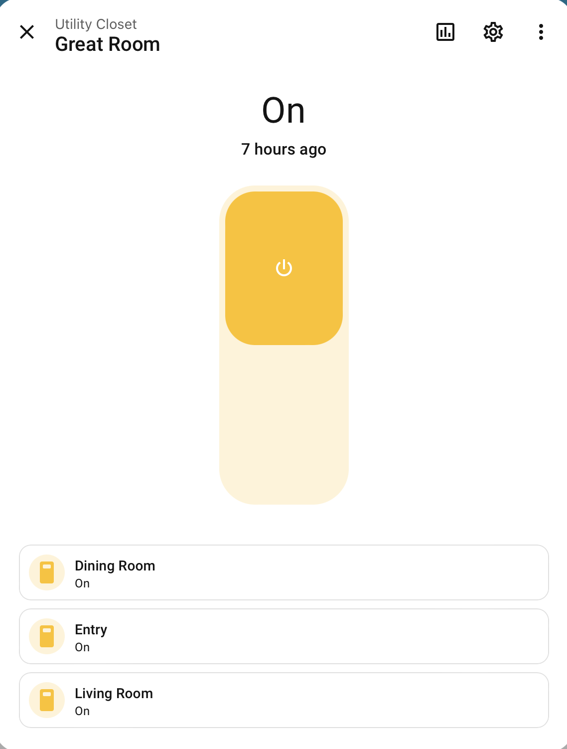

Here’s a group:
And here are the group options:
It sounds as though this is the easiest way, so I’ll keep on keeping on. Thanks for the thoughts, all.
No, what you are using is a Switch Group which is different than the legacy style groups Boheme61 mentioned… which cannot be exposed to Alexa, hence my comment replying to him.
Yeah, but I’m using the non-deprecated groups, and per above they can be exposed to Alexa. My initial suggestion was to provide a widget in the UI to easily create such groups, which gracefully works around two limitations to the “area” implementation - specifically (a) that they don’t nest, and (b) that they can’t be exposed to voice assistants. I’m not overly interested in a solution that is less capable than the one I’ve devised on my own! :slight_smile:

… or they can be changed individually in each entities’ settings (as shown in the screenshot for your Switch Group).
