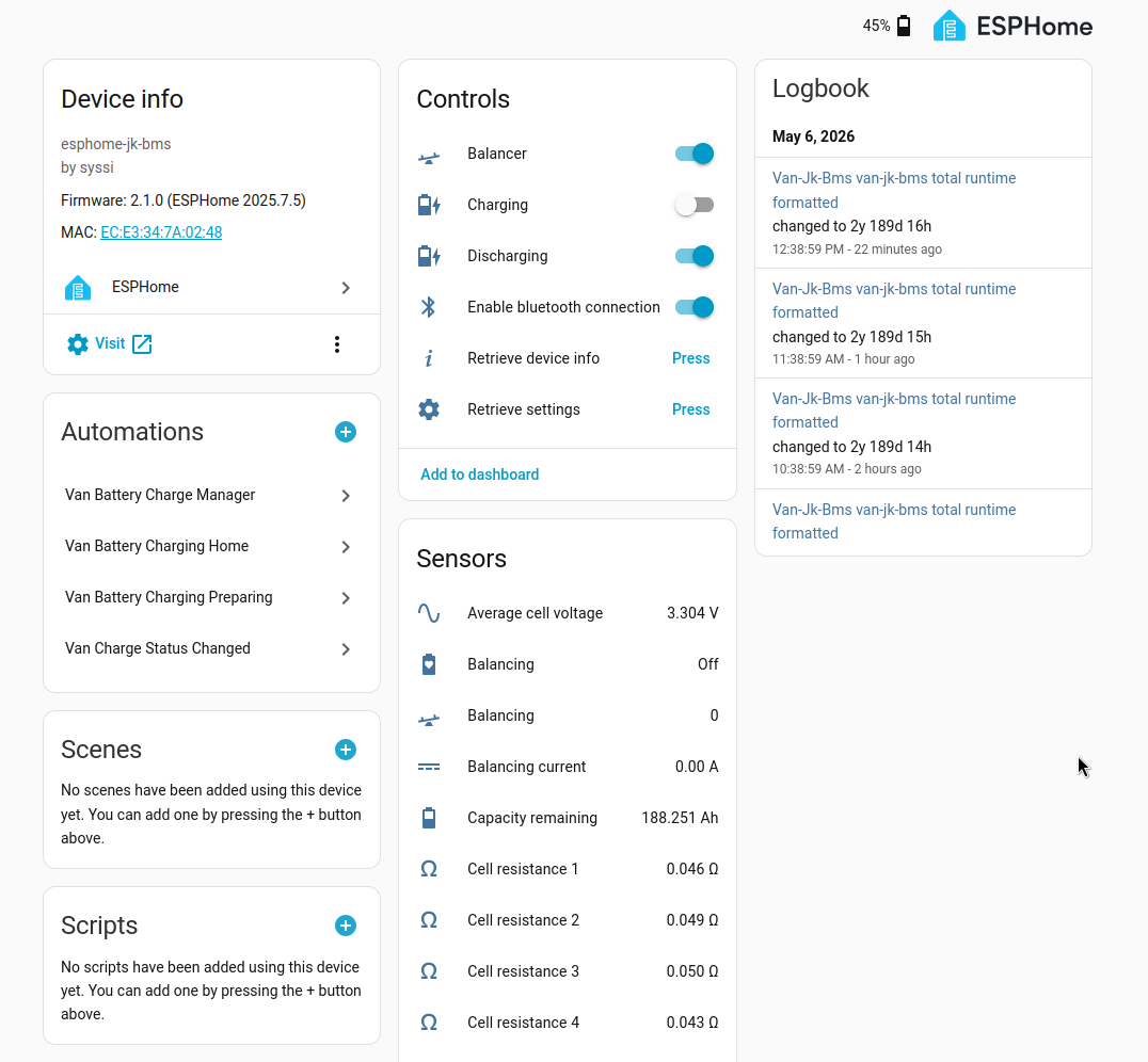

On my home assistant at home I add a new esphome device and it shows up on my default overview dashboard with everything that the device has.
I’m trying to have by default a small card show up on the default overview dashboard and much more detail once looking at the device all by itself and/or have some kind of “press this button to see everything” on the device page.

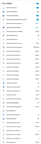

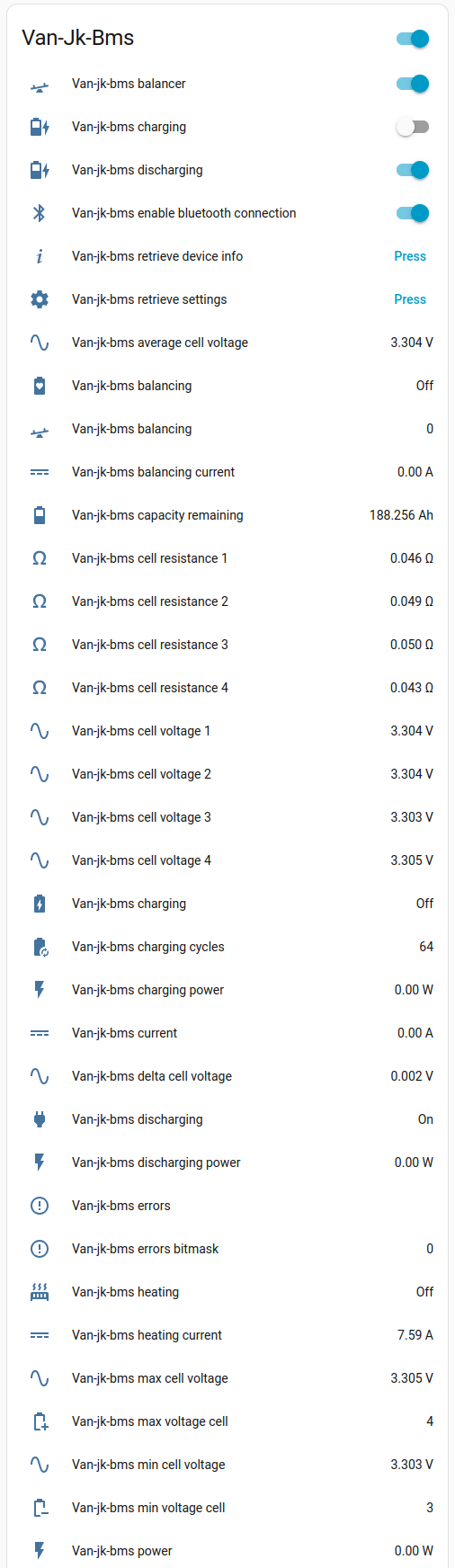

Here's an example. I have a JK-BMS that communicates via Bluetooth to an esphome device for a battery in a van. It's a VERY big default widget that got added to my default overview dashboard in home assistant.
What I'd like to do is have a much smaller default widget with say the charge and discharge switches, the net charging/discharging watts, net current, state of change as a %, the total voltage and maybe a few others like a couple of temperatures. That's only 10-15 total items and I'd like the rest of this information to be available if/when I click into the device's specific page but not for it to all go onto the esphome default overview dashboard.
So here a long list is OK, but on the home assistant home screen I'd like to see less.
I think that based on the other discussion on the thread I need to mark some of these items as diagnostic and then they'll still be visible on the device detail page without necessarily showing up on the home assistant default overview dashboard page.
I hope this is less confusing now.
