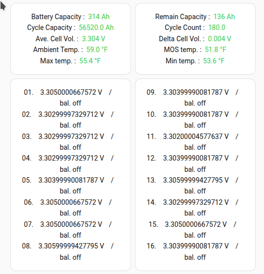

Here’s one grouping I’m dealing with:
But the main grouping will be all the BMS battery cells and I plan on adding another display of battery cells since I’ve added a balancing module which also displays battery cell voltages and line resistance so 16 of each per battery. ugh.

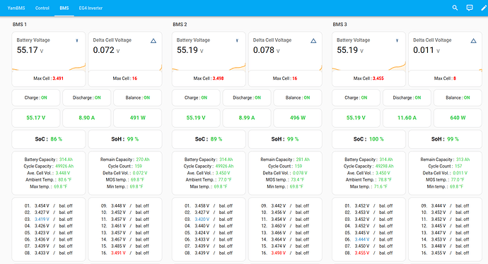

Here is one tab of my energy system display which somewhat shows all the grid card groups. It would be a shame to have to break everything into individual entities just to get the display precision stable and correct.

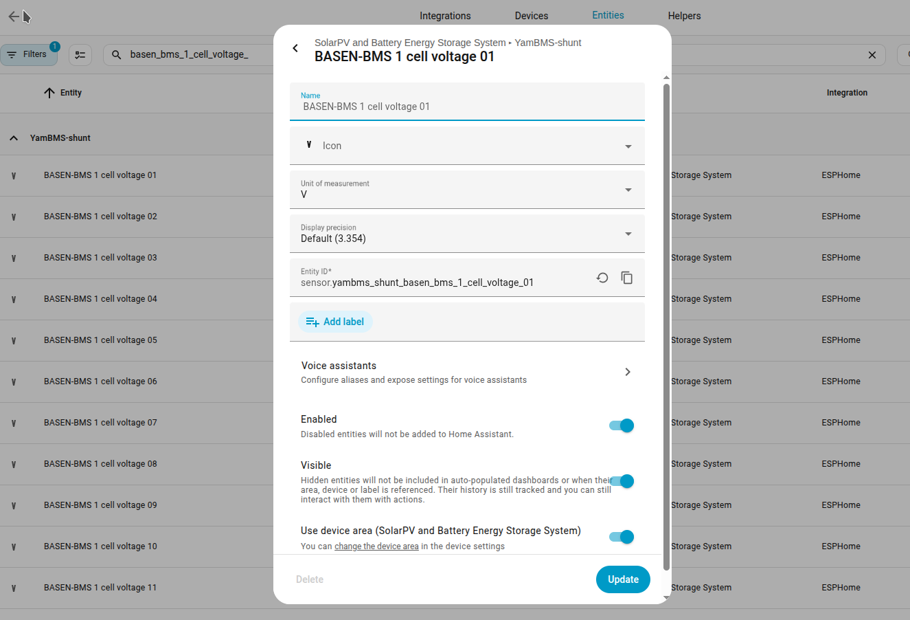

As you can see, my battery cell voltage sensors do have Unique IDs because if they did not, according to the link you posted, there would not be the reset icon next to the entity ID field.
And I can set the display precision of individual bms battery cell voltage entities but when displayed in a grid card I can not and they all display with the full stored precision unless I add something to the YAML code for the grid card at each entity listing. Like that ‘round(3)’ mentioned in my first post. But rounding sucks because it does not fix the precision and the displays will shift all over the place as things like 3.399 become 3.4 instead of 3.400.
Set the precision right here:
That will only set it for that display element AND it gets lost after a system update which drives me nuts because I’ve done this a half dozen times but the last update also changed what the battery cells are showing. And that UI 'settings" icon is not available for the entire grid card and it will not set it for everywhere else the entity is displayed like in the image where I showed all 3 battery packs each with a grid card display showing 16 battery cell voltages out to like 16 digits.

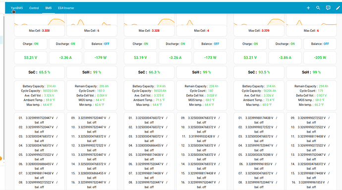

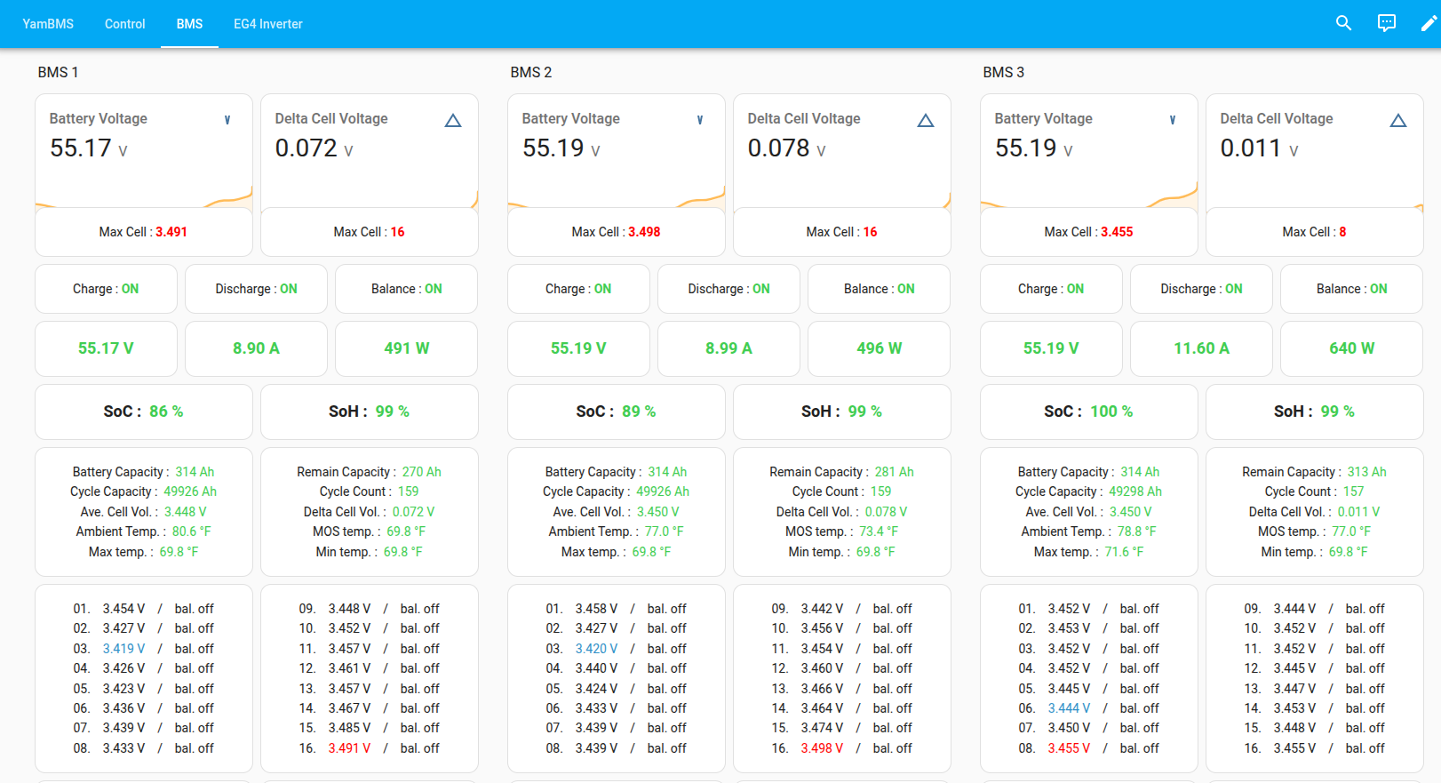

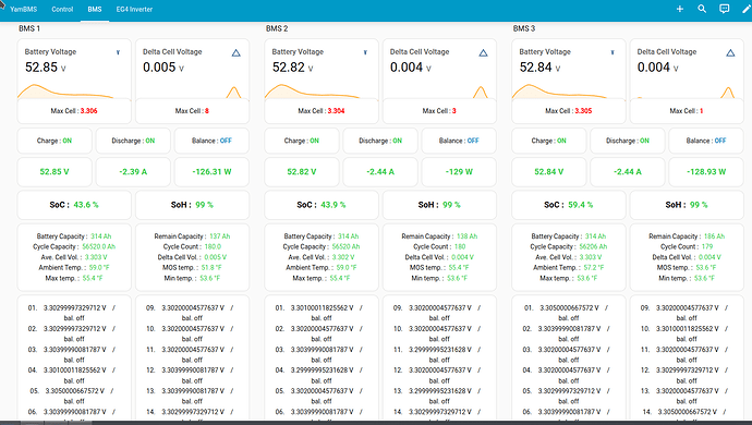

That would be great but I don’t find that factual. Here is my dashboard from Nov 25th 2025
and here it is now after updating my HA and I’ve done a hard reset of cache and data:
I checked a dozen of the cell entities and they all have the UI set for 3 decimal places.
