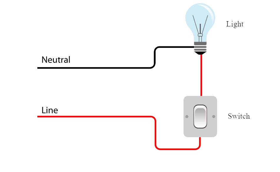

Before 2011, this kind of light circuit was allowed:
There is no neutral wire in the switch, which is where you would use a “no-neutral” switch like the Shelly. A “no neutral” switch has a small processor inside like the ESP8266 or similar. Since the processor only draws a few mA of current, the load acts as a “neutral”. In the above circuit, if you remove the light, the Shelly switch will go offline.
Since 2011 neutral wires are required almost everywhere. An exception is if a wall-switch controls a half-hot receptacle. (A half-hot receptacle is one where the top half is always hot and the bottom half is controlled by a wall switch. Think floor lamps.) The receptacle has a neutral wire but the switch doesn’t. Another exception is in 3- or 4-way switching where another switch in the circuit does have a neutral.
