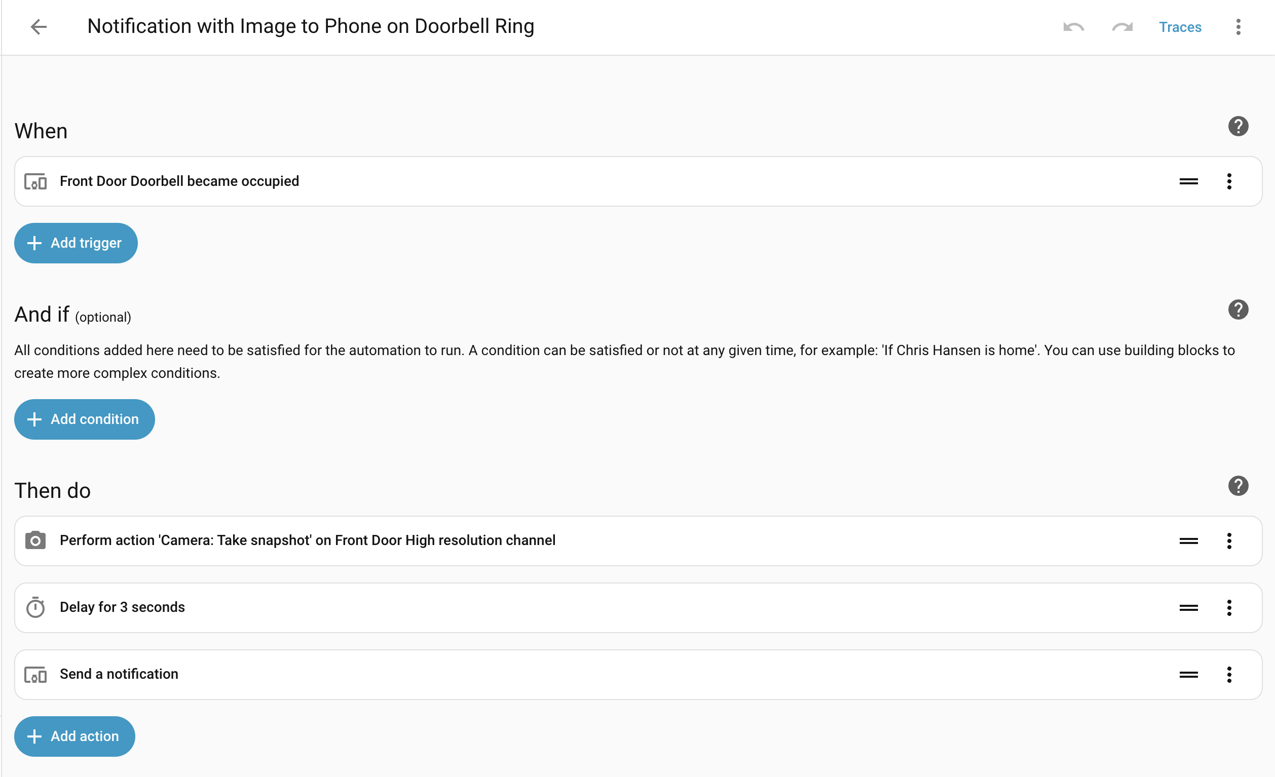

Thank you. That got me going in the general right direction and led me to other similar threads. I ended up modifying things and found the following works well. I’m using Unifi Cameras with a G4 Doorbell Pro, which uses “occupied” as the trigger for a doorbell press. The 3 second delay was to make sure it had time to save a new snapshot of that moment and the notification didn’t grab the old/prior snapshot. I’m very new to this stuff, so I’m sure it can be improved upon but it works for me.
Here’s the code in YAML

Here’s what the automation looks like in Visual Editor:
