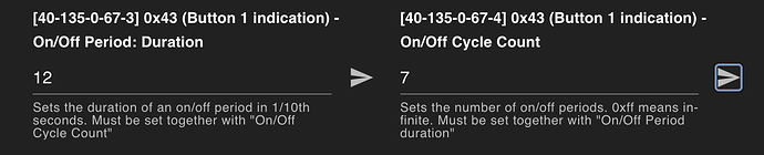

Is there a way to set two values on the same node at the same time in zwave-js UI?
These two values say they must be set together:
But clicking on the arrow to update the value generates an error. Is there a way to send two values in the same request?
You can see it attempts to set the one I clicked:

And then the node reports that the update failed. I’m just assuming it’s because they are not being set at the same time.

Thanks @freshcoast, as always. :slight_smile:
Per the solution, this flashes the light on button 1 (the relay on the Zen32) every half second (5 tenths of a second) for ten times.
action: zwave_js.invoke_cc_api
  device_id:
    - 2452e07f492b05f7f7d81900e11fbc75
  command_class: "135"
  method_name: set
  parameters:
    - - indicatorId: 67
        propertyId: 3
        value: 5
      - indicatorId: 67
        propertyId: 4
        value: 10
