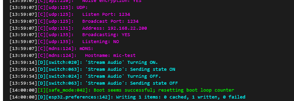

Got it done… when i active the udp stream it is counting dots. and it stops when i stop the stream.
The File is not empty…
but i cant hear anything so i will seach now on the ESP side again
-finally I got it all done … the problem was that your config is for an PDM microphone.
once changed and cleaned the build i can hear now myself in the wav file.
Great many thanks.

Please tell me the port opens but there is no sound in Stream! I will reproduce under the VLC (udp://192.168.22.200:1234) as well as under
ffplay -fflags nobuffer -flags low_delay -f s16le -ar 48000 -ch_layout mono -probesize 32 -analyzeduration 0 udp://192.168.22.200:1234
Windows10

The microphone on the device works poorly.
Data on Pines are taken with.
https://github.com/RealDeco/xiaozhi-esphome
  # Hardware v2 pin mappings
  i2s_lrclk_pin: "45"        # I2S LRCLK (Word Select)
  i2s_bclk_pin: "9"          # I2S BCLK (Bit Clock)
  i2s_mclk_pin: "16"         # I2S MCLK (Master Clock)
  i2s_din_pin: "10"          # I2S Data In (Mic)
  i2s_dout_pin: "8"          # I2S Data Out (Speaker)
Tell me what was done by me not right?!
The firmware from the hub works- but almost does not disintegrate speech!
VLC  udp://192.168.22.200:1234
 :network-caching=1000 :demux=rawaud :rawaud-channels=1 :rawaud-samplerate=16000
