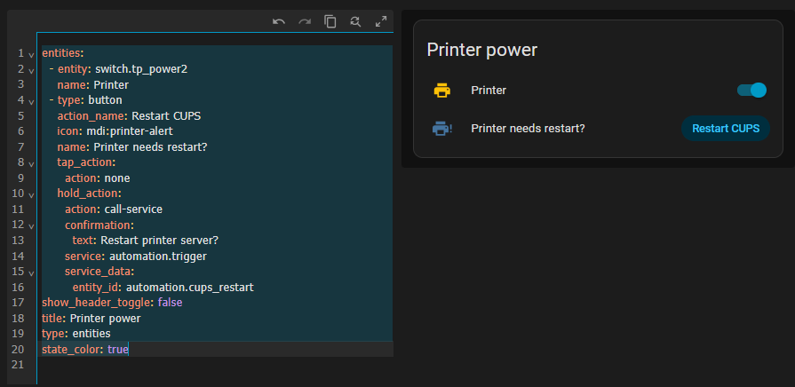

In my situation from time-to-time CUPS printer service ( on another RPI in network) needed restart, simple button was no go ![]()
Made it react on button long press and confirmation pop-up using hold_action confirmation: ![]()
entities:
- entity: switch.tp_power2
- type: button
action_name: Restart CUPS
icon: mdi:printer-alert
name: Printer needs restart?
tap_action:
action: none
hold_action:
action: call-service
confirmation:
text: Restart printer server?
service: automation.trigger
service_data:
entity_id: automation.cups_restart
show_header_toggle: false
title: Printer power
type: entities
state_color: true
Automation executes remote shell script after positive confirmation.
Best and hope it can give some idea, JR
