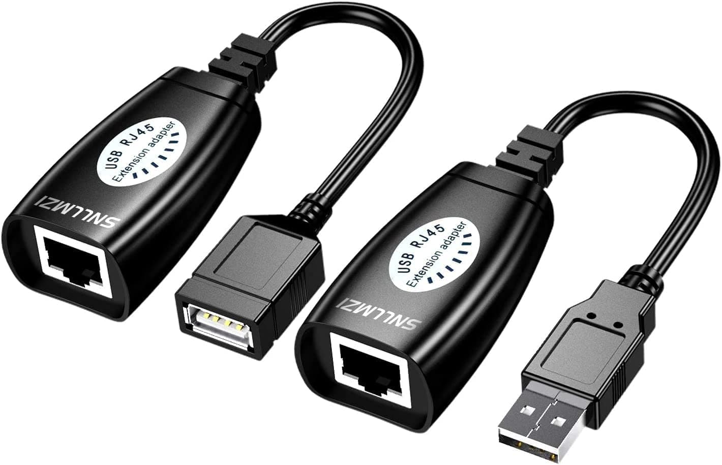

Probably something like this Amazon.com: USB Over Cat6,SNLLMZI USB RJ45 Extender Over Cat5/Cat5e/Cat6/Cat7/Cat8 Cable Extension Cable Connector Adapter - 2 Pairs : Electronics which isn’t really Ethernet, just uses the same cable.
USB 1.0 operates at 12Mb/s maximum which is far higher than the serial speeds used by the Z-wave controller. You shouldn’t have any issues at all.

  2. CAT6 is a cable standard, not a network protocol, so it’s not USB over IP, AKA USB over Ethernet (the link to “USB over Ethernet” is actually a regular USB Ethernet card, this is an actual USB over Ethernet solution). USB over IP is not stable enough in my experiece with it, I tried several in my previous job and stopped using them. USB over CAT6 is just as stable as a regular USB cable, but the speed is limited in affordable versions. There are also HDMI over CAT6, sound over CAT6 and probably other things as well that I haven’t used. CAT6 is used because it is less prone to noise than CAT5e.

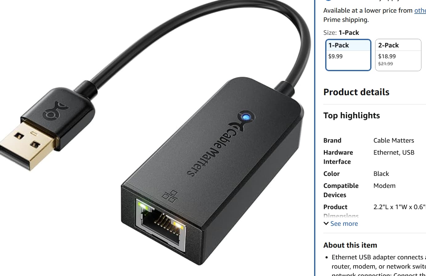

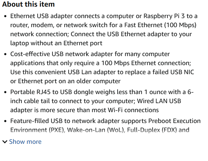

OK, if that’s what you sendt, Amazon probably did something, because that’s not what I got here. This is the description and picture that I got from that link:
Note that it’s a one pack, but you can get a two pack. It’s a regular USB network card. As for the USB over CAT6 that I use I have been using them both in my previous job and privately for many years, never had problems with them.

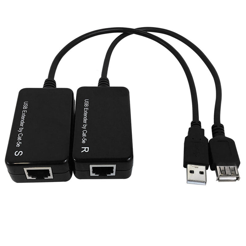

I have had this running for more than a month now, and it’s rock solid. No problems at all, and my previous problems were solved. I won’t recommend anybody else because YMMV, but I have around 30 meters CAT6 running from the cellar (technical room) to a storage room in the attic. The type of USB over CAT6 is something I have had for years, as I said above, and it looks identical to this type.
I have not tried the even cheaper version, which I have a few of, but I’m guessing they may also work.
