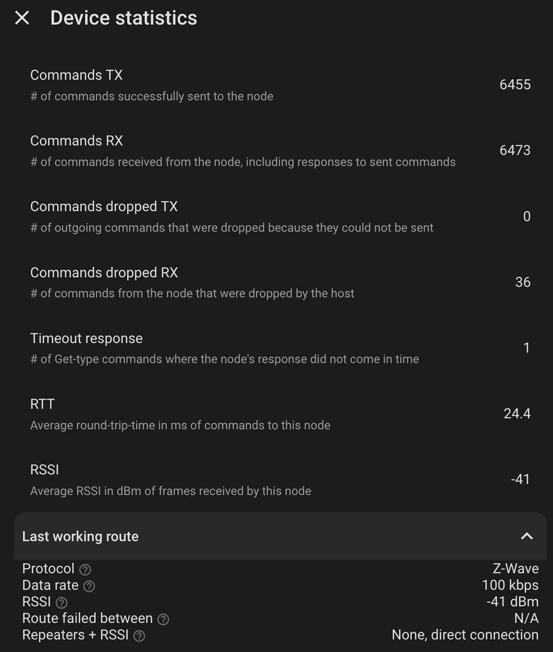

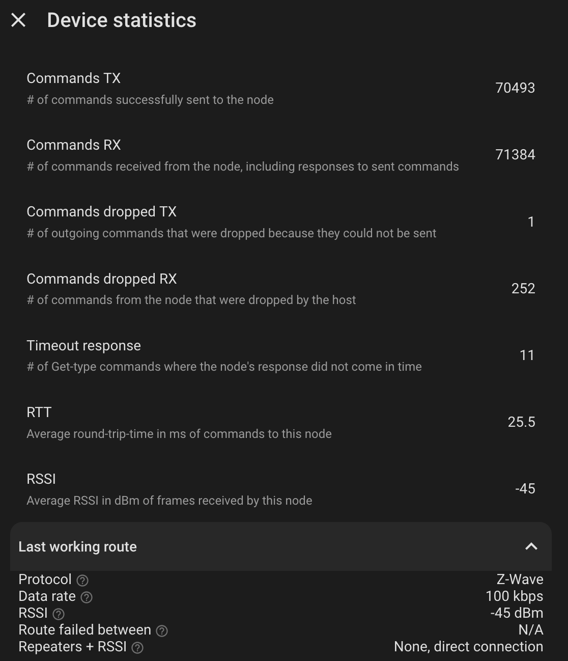

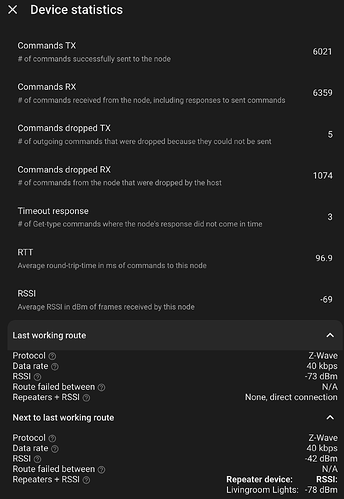

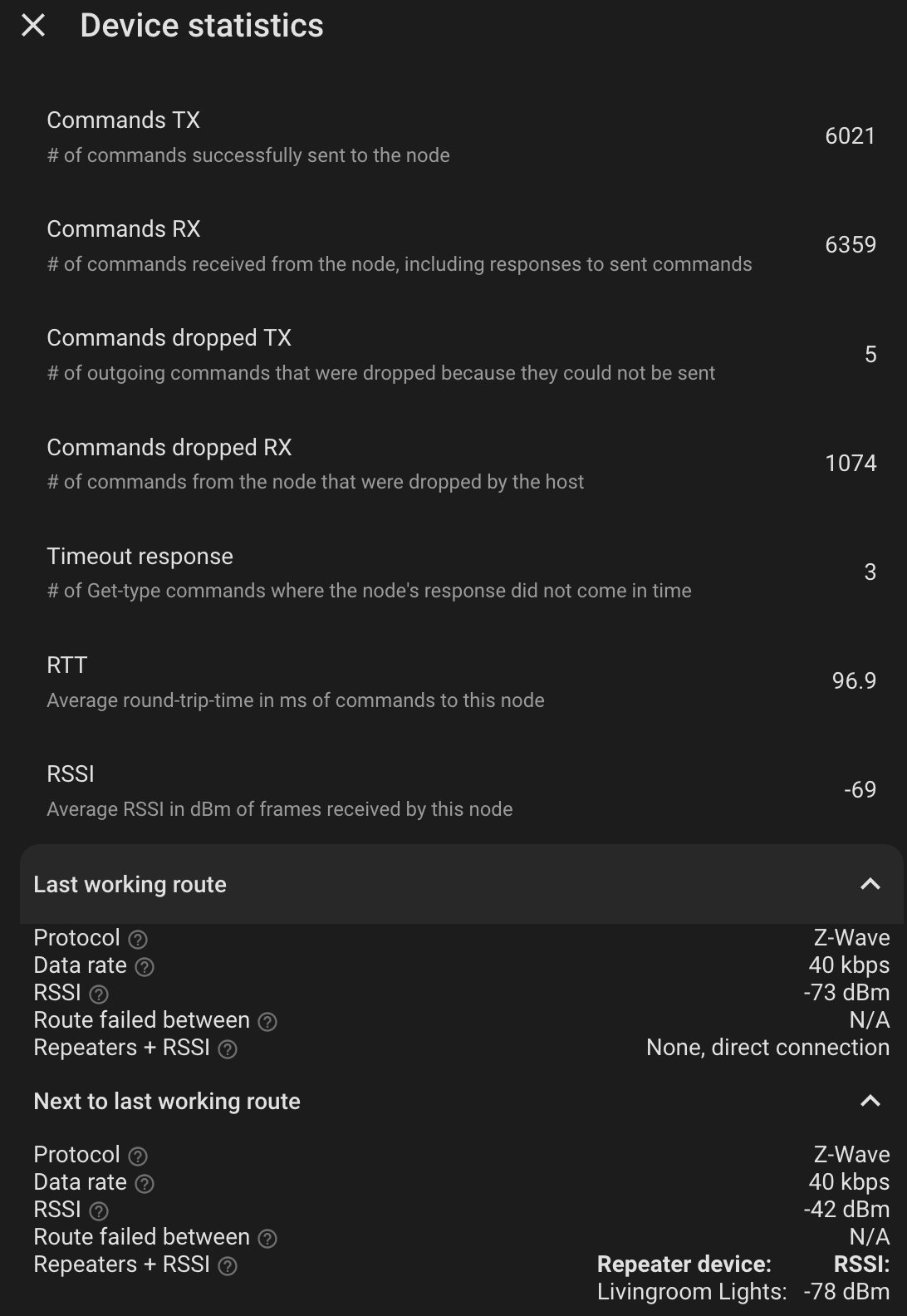

Are the dropped commands a problem here? I expected many more given that 5/6 times the physical state doesn’t get reported. I don’t notice any difference in reliability between the switch with 36 dropped RX commands, and the switch with 1074 dropped RX commands.
Upstairs switch (about 5m away, through the ceiling/floor):
Downstairs switch (6m direct line-of-sight to ZWA-2):
Thermostat (5m direct line-of-sight to ZWA-2):
