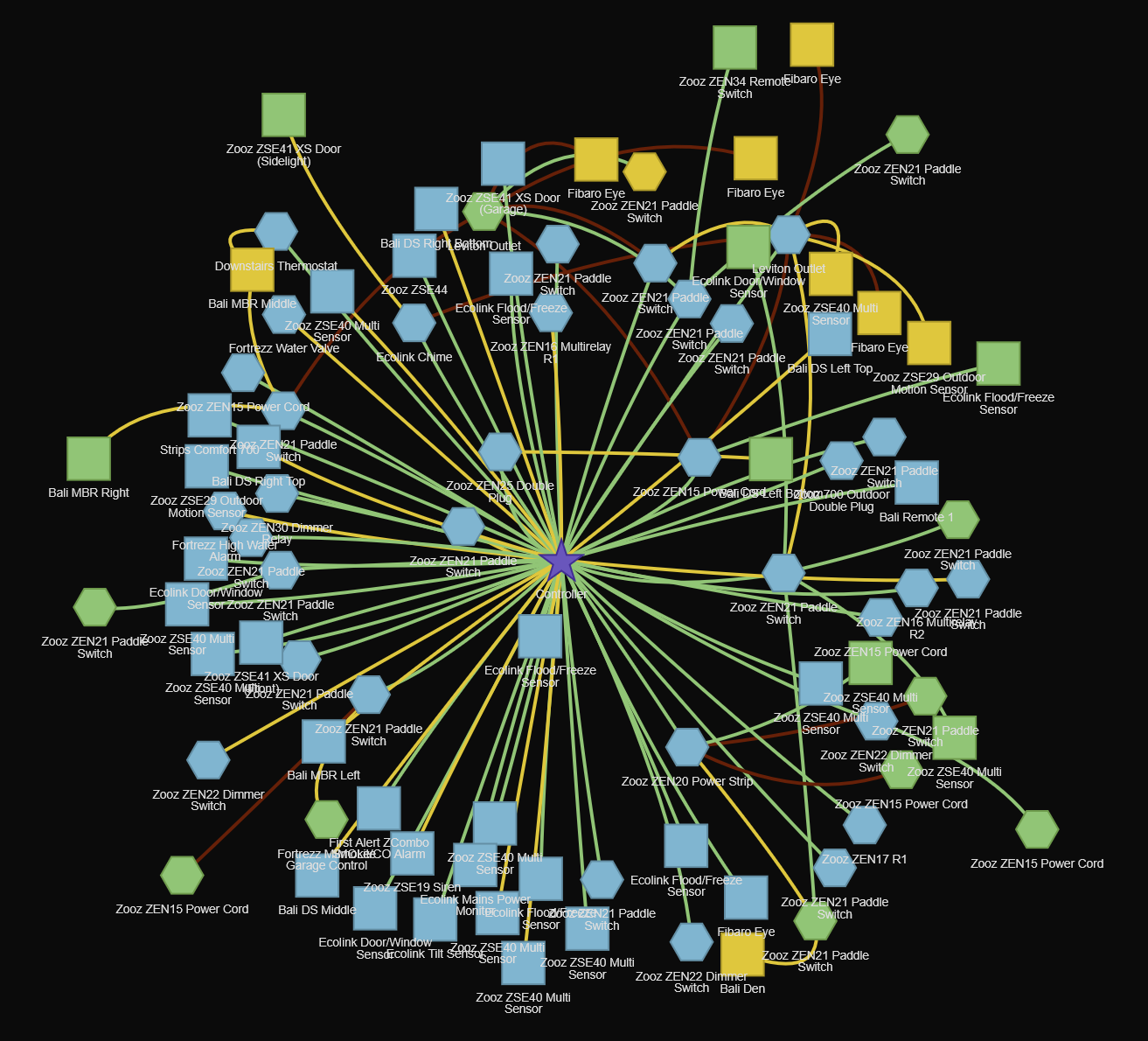

What’s interesting to me is that when I look at the Network Graph, as I reported earlier here and elsewhere, I see more direct routes and fewer hops than I had with the Z-Stick 5+, which I attribute to the power/range advantage of the ZWA-2. So, maybe the issue is NOT with the radio, but with the comms FW. Here’s the latest graph:
Previously, there were many more red lines (slower links) and many more 2, 3, and even 4 hop, routes. Also, I have only a couple of new LR devices, and chose NOT to include them as LR, but as mesh. So, comparing this NW Graph to my previous one with the Z-Stick 5+, by all indications I should have a faster, more robust network. But I don’t.

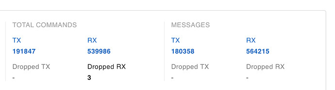

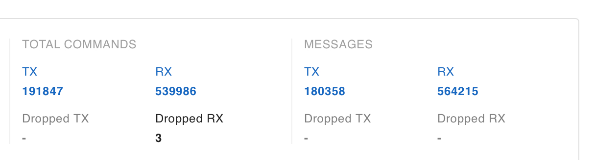

Those stats do not look great. Here are mine from Gen 5 stick.
You have a lot of nodes. In my study of gen7/gen8 issues there seems to be a challenge when dealing withvery busy networks. Many examples of networks that were fine on Gen 5 and then have issues on Gen 7 / Gen 8. Take a look at the RX stats to identify the nodes that are chatty and see if they can be reduced via config. Also, look at the failure stats for each node to see if it is specific nodes. Check out this link for a script

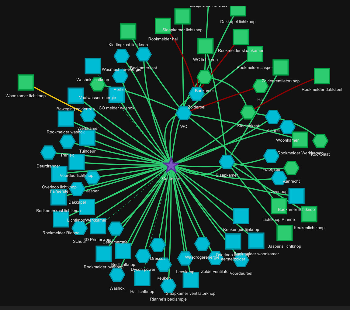

It may not be of much comfort or help, but I migrated grom a gen5+ to ZWA-2 and indeed have a stable mesh which is much more responsive. I do not turn off any reporting. I did rebuild routes when I got it. That took a long time, before that I had many devices that were really slow to respond.
I do include devices unsecure because very few of my devices support S2 security and I avoid S0 security like the plague. I also do not have locks and such requiring better security. So my question would be do any of your devices use S0 security: if so, include them with whatever else because S0 security is known for problems like these.
That’s interesting. Your network looks a lot like mine. Maybe I need to manually rebuild ALL routes as suggested. How did you go about that? First powered, closest proximity to furthest, then battery?
To answer your question on security, most of my devices have no security (a red “-”) under the Security column in the UI. A handful have a combination of S2 Authenticated and S2 Unauthenticated, everything is “Beaming”, and most of them are Z-Wave+ V1, with a handful that are V2, and 3 that are not Z-Wave+, if that matters here.
I used the big bang: rebuild all routes. I woke up battery powered devices. It will lead to times where the whole network goes down for quite some time, but when all is done it all comes back to life. At the end I looked at the graph and manually did a rebuild routes on single nodes that seemed to have not so great connections.

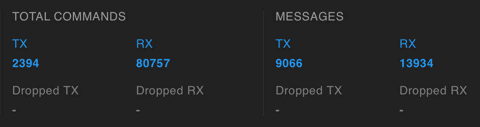

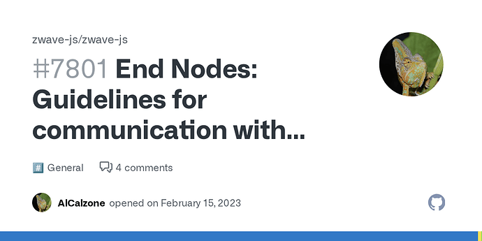

You may want to review this issue to see if it applies to your system. Does the controller ever report jammed?
This is not low, it is an RX every 5 seconds.

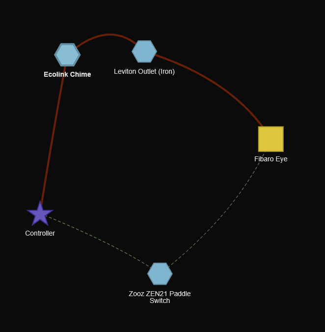

After the rebuild, I seem to have more red connections than I did before, and many nodes with multiple links, which I didn’t have before. Like, for example, what is this graph telling me?
This particular device is in a floor below the controller, and a floor above two of the three relay devices. The ecolink chime is about midway to the Fibaro, which is on the same floor, yet it chose to go through the floor twice to reach it instead. Why There are multiple wall switches and plug-ind devices on the same floor with a more direct, much shorter route than any of those three listed. Maybe this is the best it could figure out with a battery device that is only awake every 2 hours for 5 seconds. It appears most battery devices don’t stay awake when in the middle of a “process”, like rebuilding routes or something that might last longer than the programmed “wake” cycle time, which requires constant reawakening when doing these things - which seems like a network design flaw to me.
