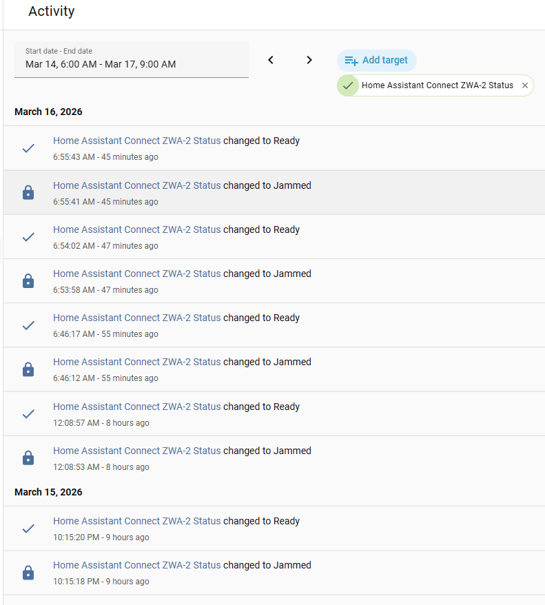

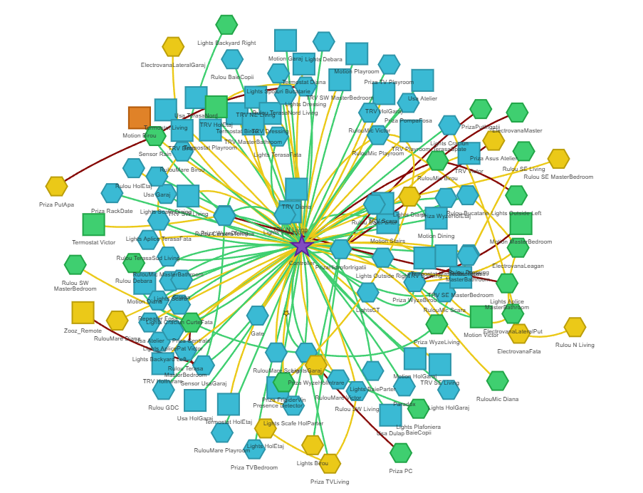

i recently switched from Fibaro HC3 to ZWA2 and i’m experiencing some issues. While the network (123 nodes) seem to work ok, the ZWA2 gets jammed quite often.
The ZWA2 is placed in the middle of the network, connected over POE. ZwaveJS UI runs as a docker container on my TrueNas server that hosts also the HA VM.
After a lot of poking around i could say that most of the jams occur when a route is not working so either the controller or the node has to do a network wide call to establish a new route.
Anyone else having this jammed issue ? and how often ?
Regards,
I recommend the advice posted earlier about rebuilding routes one at a time for each device starting with the closest one. Otherwise you’ll be waiting FOREVER for the network to stabilize. I suffered from a lot of things not working reliably at first, which is why I started this thread. But the advice to rebuild routes manually, while a real PITA, especially if you have a lot of battery devices, solved the problems for me. My network seems rock solid now and many of the routes are faster than they were, in general, with fewer hops. All of that indicates that the radio is indeed more powerful. You’ll get there.

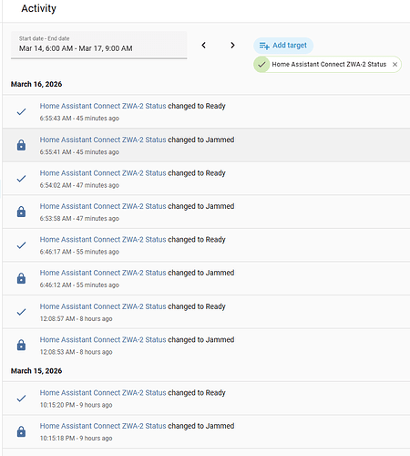

So you dont have any ZWA2 jams in the activity logs ? Because i did rebuild the routes, and the network works when the ZWA2 is not jammed - which most of the time it auto recovers in 2-3 seconds. During that time obviously nothing works and the network has a delay.
TBH, I wasn’t logging the status, but after seeing your reply, added it to Recorder. When I first installed the ZWA-2, I would notice the blue LED go off A LOT initially, and I didn’t know why. But, in the ZW UI, I did see an intermittent message appear when that happened about controller “off line” or something like that. After rebuilding the routes and things working correctly and stabilized, I haven’t paid much attention, but also never notice the LED going off anymore.
Since 3 pm yesterday, I have logged 4 jams, two were 1 second in length, and two were 3 seconds in length. I don’t know what caused the jam, and not sure that is even logged. I have about 100 devices and probably around a thousand entities. I disable any I don’t need, but that is a never-ending chore since ZW/HA keeps adding new ones with various upgrades, some that are nonsensical for the devices they belong to. Like a “water sensor” for a motion detector. Weird. I also standardize wake up time for battery powered devices, minimize reporting to ONLY those things that I use, and set timings for those to minimize traffic while providing the granularity I need.
It takes ongoing effort, but it is worth it to keep things running smoothly. Hope that helps. Maybe someone with more knowledge of the ZWA-2 or ZW controllers in general can chime in to tell us what might be causing the jams, and if some are “expected” on any network. I suspect it is inevitable. Cheers.
