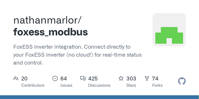

I am running the following Fox ESS integration in HA.
