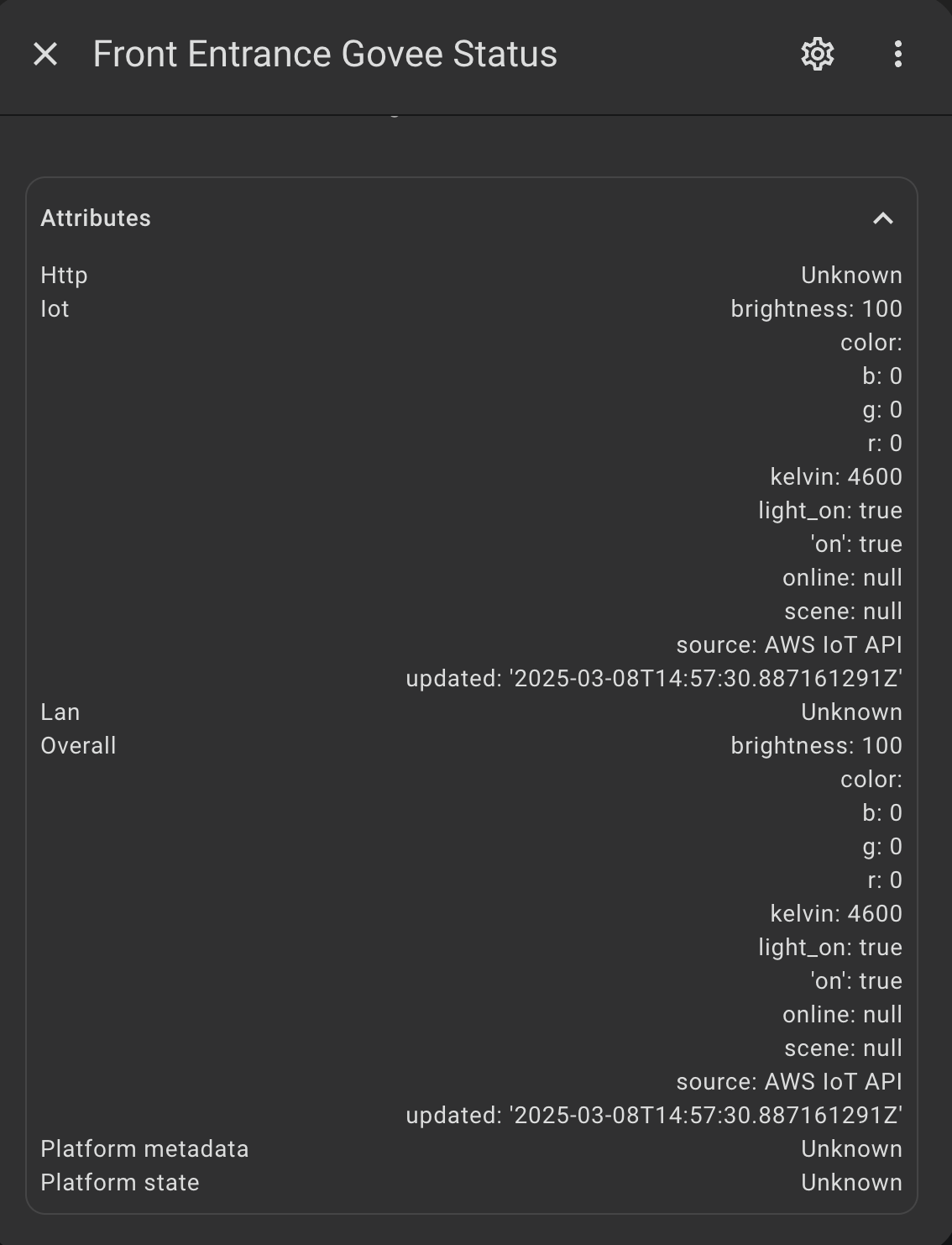

This is what the attributes look like in Developer Tools:

Unfortunately, this give me an “unknown” response. I wonder if that’s because there is some kind of “nesting” of attributes. When I expand the attributes list in HAOS, it looks like there’s an “IoT” section and an “Overall” section which repeats the same attributes.

Do I need to change my
Ok so after a bit of tinkering, I am making some progress.
If I change the sensor to this…
{{ state_attr('sensor.front_entrance_govee_status', 'iot') }}
The result then is this…
  "brightness": 100,
  "color": {
    "b": 0,
    "g": 0,
    "r": 0
  "kelvin": 4600,
  "light_on": true,
  "on": true,
  "online": null,
  "scene": null,
  "source": "AWS IoT API",
  "updated": "2025-03-08T15:32:12.390749747Z"
Now, how to get at those other attributes?
