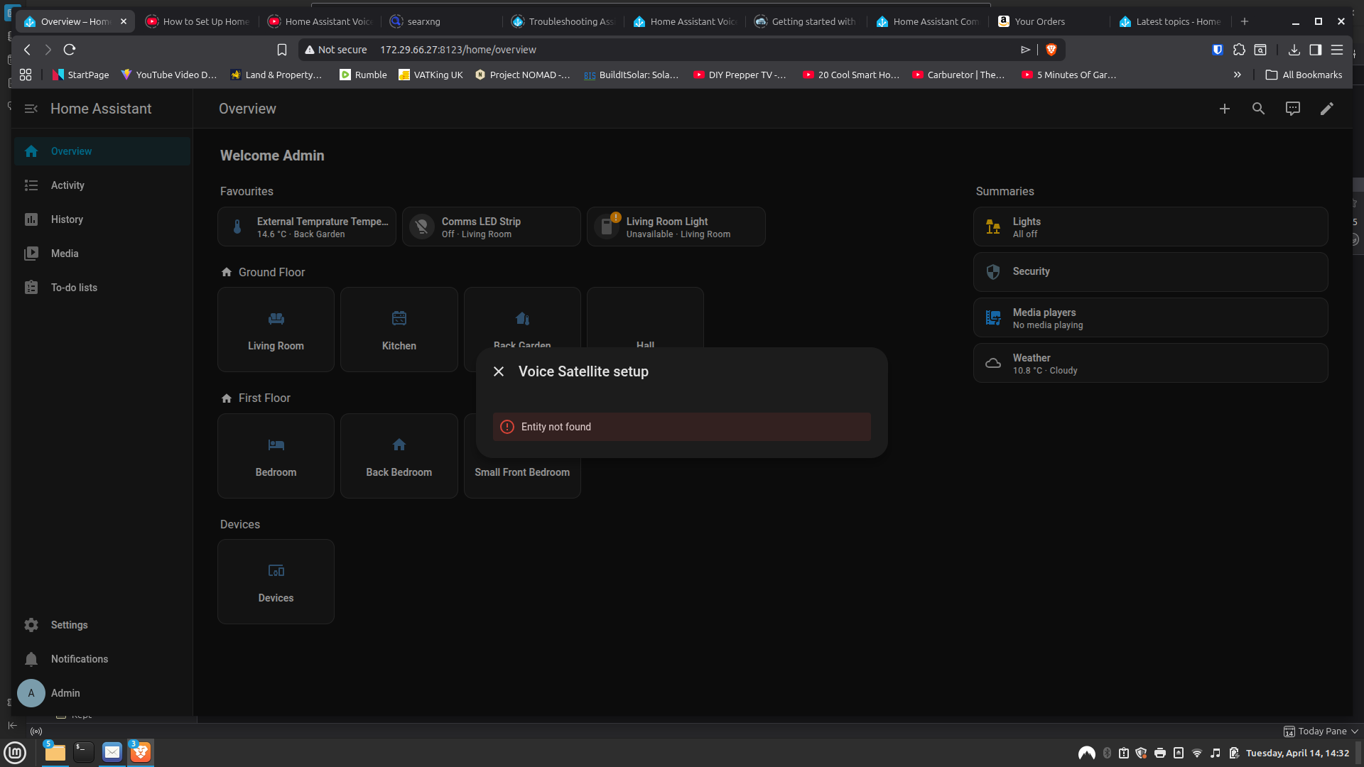

The instructions are simple enough. I don’t like the cloud so assistants like Amazon, Google, etc do not exists and I don’t have a smart phone. So I started install from the HA panel. All went well until it finished the firmware upgrade when it came up with Entity not found.

Yes. I then entered the WiFi and all the way through setup 6 until it updated my firmware then it hit the error. Although I wasn’t using a phone the steps look the same.
I cleared it from HA and reset the device and did it again. Still exactly the same except this time it just checked the firmware and then hit the error.

Just noticed in your screenshot, you’re accessing HA from a 172.x.x.x:8123 IP address. I would expect to see a local 192.168.x.x:8123 IP address. I think 172.x.x.x is an internal address inside the HA Docker container.

I added in whisper and piper and reset the PE and installed again. Exactly the same issue. The IP for the PE was 172.29.66.245 which is on the same subnet as the HA server.
