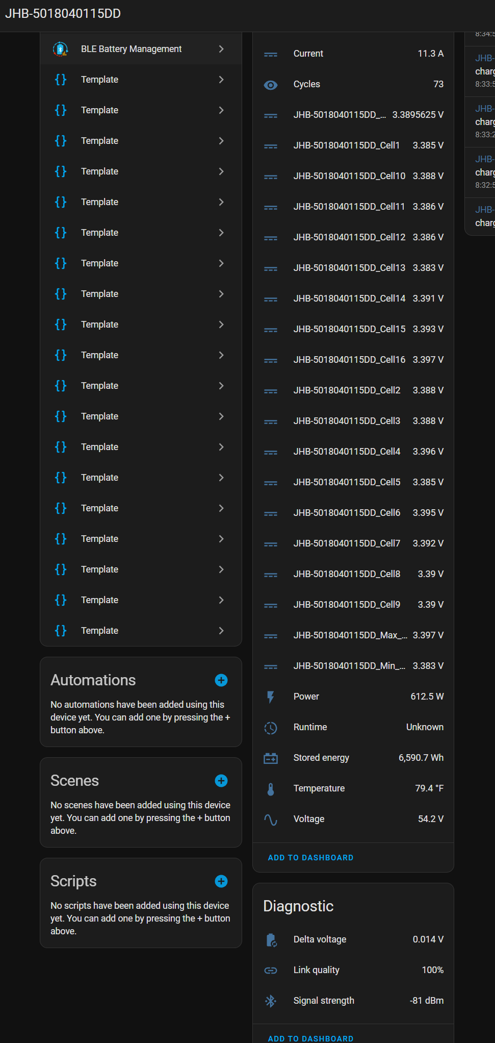

Wow, thanks for the tip. Just managed to get it to work after understanding ESPHome bluetooth proxy. Thank you!
@Working really well for me. Only issue is esp32 gets disconnected sometimes then need to reboot esp32.
very nice… wish they would incorporate the individual cell voltage sensors. Took me a while to create all 16 of them.
Have any one figure out how to get the total charge and discharge WH numbers? I want to add the default power dashboard to record the wh that’s used to charge and discharge the 100balance bms batteries.

And later use integral helper to change this into energy. Mind you this is an example of old config I have where my power came from my inverter. Now the BMS_BLE integration provides me with energy in Wh so probably that could be used directly after a bit of mathematical processing.

Yes, it’s for default HA Energy Dashboard. I’m also using the BMS_BLE integration but can’t figure out a way to track “used” watt. There’s only 1 field that shows WH (stored energy)
. I don’t see a way to track “used” watt over time… Feel like it has to be provided by BMS to keep track and gets reset daily just like JK BMS.
