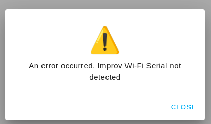

I’m trying to use new ESP32-S3-WROOM-1U-N16R8 I just bought to automate a relay.
When trying to install EspHome on the device using “Prepare for first use”, it works but after the installation I get the following error:
and the following logs (it stays the same also when restarting)

And the device does not react after this point, I can only restart, and it does the same thing.
I also tried a lot of different option (board, variant, PSRAM, custom partition…) when compiling the “.bin” file from a yaml file in ESPhome but nothing works, I always end up with the following logs:
[00:24:00]ESP-ROM:esp32s3-20210327
[00:24:00]Build:Mar 27 2021
[00:24:00]rst:0x1 (POWERON),boot:0x8 (SPI_FAST_FLASH_BOOT)
[00:24:00]SPIWP:0xee
[00:24:00]mode:DIO, clock div:1
[00:24:00]load:0x3fce2810,len:0x1870
[00:24:00]load:0x403c8700,len:0x4
[00:24:00]load:0x403c8704,len:0xc40
[00:24:00]load:0x403cb700,len:0x2ee8
[00:24:00]entry 0x403c8900
Do you have any idea for a resolution?
