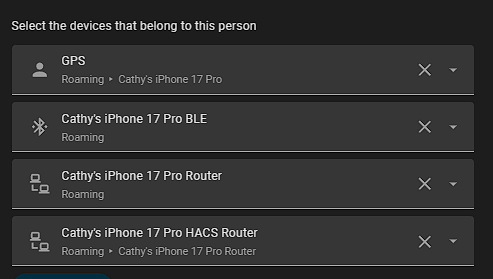

I've got mine to set up 4 ways for each person for reliability (one android, opne cell phone). Showing as home when you are home is much more imnportant to me (so lights do not go off when there etc.). I use this combo for each person:
GPS
Router (Official TP-Link WiFi integration)
Router (HACS TP-Link integration)
BLE
It takes about 10 minutes of not being home for all four to them finally switch to the phone not being there which is fine with me, my main issue was getting it to trigger as being home the second we arrive. Only after all 4 show as not home then that person entity is shown as not home - because you really know for sure they are not there.
Then when we arrive, before we even reach the door typically the ble triggers first. As soon as any of them show as home then the person is shown as being home.
The above serves us well for our purposes. It works flawlessly (but never for immedately after leaving, as per above, but always becomes correct, 100% f the time). This is the way. Example:

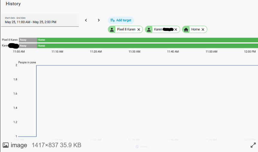

Go to your History dashboard on HA and add the device, person, location, SSID and other location- or network-related entities so that we can see what happened when. Also provide the times and traces of when the automation triggered.
Thanks, that is useful to know, how to use the History feature. I've started working on it.
