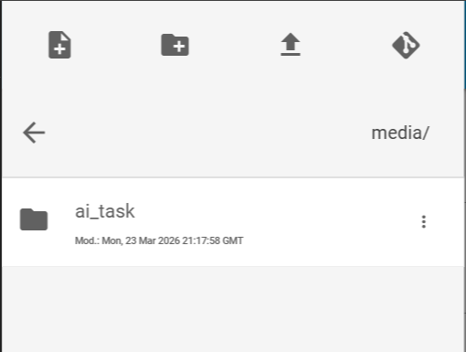

Well I am using the standard ai_task.generate_image action which accoding to the docs AI Task - Home Assistant is returning a URL “The URL of the generated image, without the host part. The URL is only valid for one hour.” as a response.
I also do get that respones and can store it in an Trigger based Template Image and use that template image in a dashboard.
All of that is working. I also know where the file is and can access it via the Media Sources its stored under media/ai_task
The issue is that as far as I´m aware of there is now way to use this in a dashboard. You have to either have a trigger based image template (which is lost after each restart) or something else which is the reason why I am asking here if anyone else has an idea.

OK. If you have trouble connecting to an image in the media-source location, there is a post that might help.

@Sir_Goodenough Thanks for the help and that post! It definitely helped, at least by getting me to stop saving this in my config folder. I just made a sub-folder in the media folder instead and I’m using the snapshot function instead of the downloader there now.
Since it unfortunately doesn’t solve the main issue (template image entities with a trigger still disappearing after a restart), I’m just going with a workaround. I’ll save it via snapshot and use that as a fallback on my dashboard: if the dynamic image fails to load, I’ll just display the fixed one.
Also deleting it daily so that only one image is saved there and the folder doesnt get bloated with the images.
@VietNgoc Thanks a lot for that input! Definately a smarter way to save that instead of the using the Downloader integration as I did before.
Since the original issue unfortunately still persists (template image entities with a trigger disappearing after a restart), I decided to just go with a workaround. I now save the image via snapshot and use it as a backup/fallback. If the dynamic image fails to load or goes unavailable, I just display the fixed static one.
For anyone curious how I managed to set this all up, here is the full breakdown:
