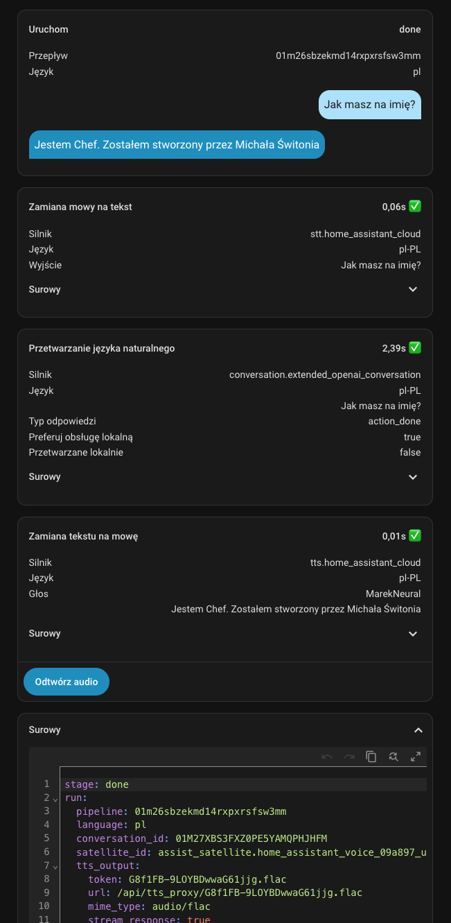

Let me show two calls to the same model. I’m using Extended OpenAI Conversation.
First message: proper one
So the first one is just calling agent (built using Docker Agent). The thing is answer does not require usage of any tools.
“who are you?”
System prompt address this so the answer is immediate: “Jestem Chef Zostałem stworzony przez Michała Świtonia” (it’s in Polish but it doesn’t matter)
Directly calling API returns:

and here is the result of Debug for Conversation Agent:

and in the end a message is properly processed and returned to me (written or said on my HA Voice PE)

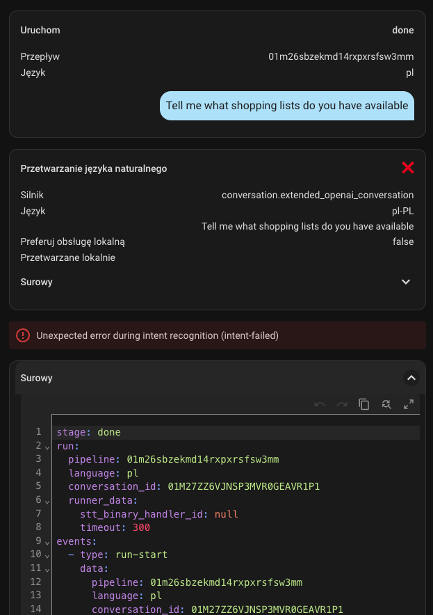

Second message: failed one
Tell me what shopping lists do you have available
This this processing requires tool calls.
Raw answer from model look like this:

I see that response contains escaped arguments which in this case causes issues.
Here is Output presented by Debug Conversation screen:
init_options:
  start_stage: intent
  end_stage: intent
  input:
    text: Tell me what shopping lists do you have available

  - type: error
      code: intent-failed
      message: Unexpected error during intent recognition
    timestamp: '2026-09-11T10:24:58.232678+00:00'
  - type: run-end
    data: null
    timestamp: '2026-09-11T10:24:58.232791+00:00'
started: 2026-09-11T10:24:48.501Z
intent:
  engine: conversation.extended_openai_conversation
  language: pl-PL
  intent_input: Tell me what shopping lists do you have available
  conversation_id: 01M27ZZ6VJNSP3MVR0GEAVR1P1
  device_id: null
  satellite_id: null
  prefer_local_intents: false
  done: false
finished: 2026-09-11T10:24:58.232Z
error:
  code: intent-failed
and now we see: Unexpected error during intent recognition
Can anyone help me with that. I don’t think I have possibility to impact how tool calls look like in response from Docker Agent.
Docs for Docker Agent does not mention anything regarding that.
I don’t assume it’s an issue of Extended OpenAI Conversation addon.
I’m on latest HA version:
Short version.. ^^^ that is the generic error that gets thrown when your tool fails and throws an error and the conversation agent can’t deal with whatever the tool did.
Meaning in almost all cases when you get this error… you MUST fix the tool. (and thank goodness because my Polish sucks and I really didn’t want to have to read it… :rofl:)
If you did not write that tool you need to go to the person who did and get it corrected. If you did write it then correct the error
Other things that produce this result include timeouts never returning the result to the agent - at about 90 seconds you get this…
