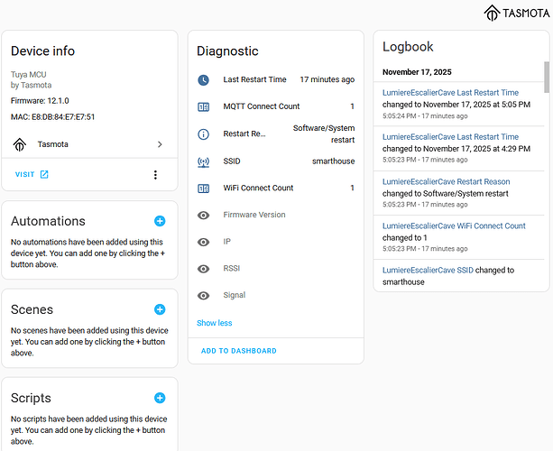

Hi, I’m replacing an old Moes 3-way switch (that had Tasmota) that died with a Martin Jerry 3-Way switch. It’s all configured and controllable through the web interface and visible in Home Assistant, except, I can’t control it in Home Assistant :slightly_frowning_face: It’s tied to the Tasmota integration. This is all I’m seeing:
It doesn’t have the ‘Control’ section so I can’t control it from Home Assistant.

My own Tuya Tasmota switches are at firmware level 12.2 (if it ain’t broken, don’t fix it) while the Martin Jerry switches were at 12.1. I upgraded the switches to 12.2 that did the trick. So either the firwmware in the Martin Jerry switches were messed up or a bug in that firmware level caused issues with Tuya controlled switches. It’s fine now. Never got an answer from Martin Jerry tech support, so I ain’t impressed with their after sales support. Last time I’m buying switches from them.
