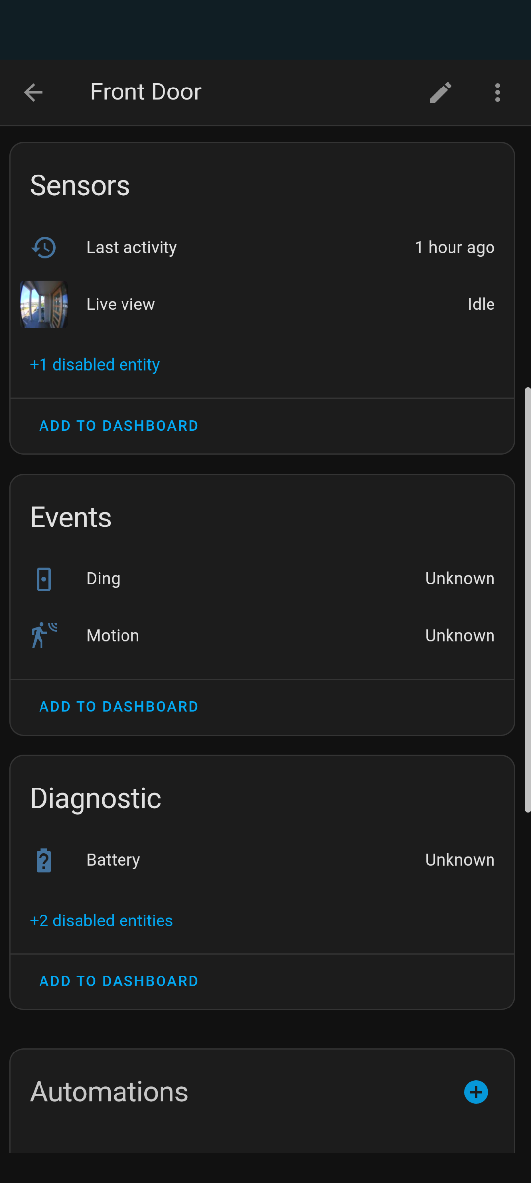

Hi all
I’m using to create an action both for when my doorbell senses motion and when the button is pressed. The problem is that both these entities report as unknown. I thought it may have been due to not having a Ring subscription so I went and paid for that and the issue is still present.
Can someone point me the right way so I can get this to work? Surely I’m not the only person who has this issue.
Thanks in advance!
I’ve just visited a mate who has Home Assistant and Ring and his is fine. I just uninstalled the Ring Integration and reinstalled it and I still have the issue.
Have you checked the Entity ID’s if they maybe changed?
Click on on “Ding” then the cog icon top right corner to see what the Entity ID is.
See if it maybe appended with a _1 that could be a cause.
Thank you for replying, I really appreciate it!
It all looks fine to me.
