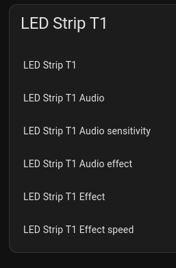

I paired the strip with Z2M without any issue, it seems to be perfectly recognized and I have no issues controlling the device manually. But here is the thing: When I add the strip to a scene, I get this in the graphical editor:
For the Effect, the default is rainbow1 and I cannot change it to something like none. I never touched the effect to begin with, but the strip always goes rainbow, when the scene is activated.
