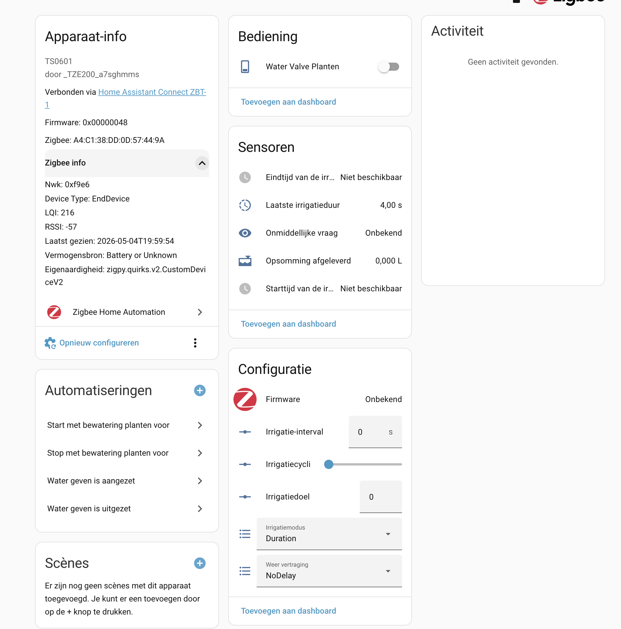

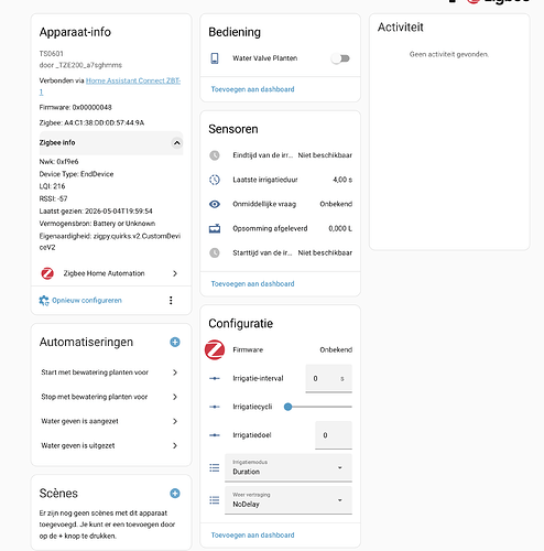

I put some screenies up from the product and the details in HA.
Tuya generally does not offer firmware because the firmware is built by the company releasing the device, not Tuya.

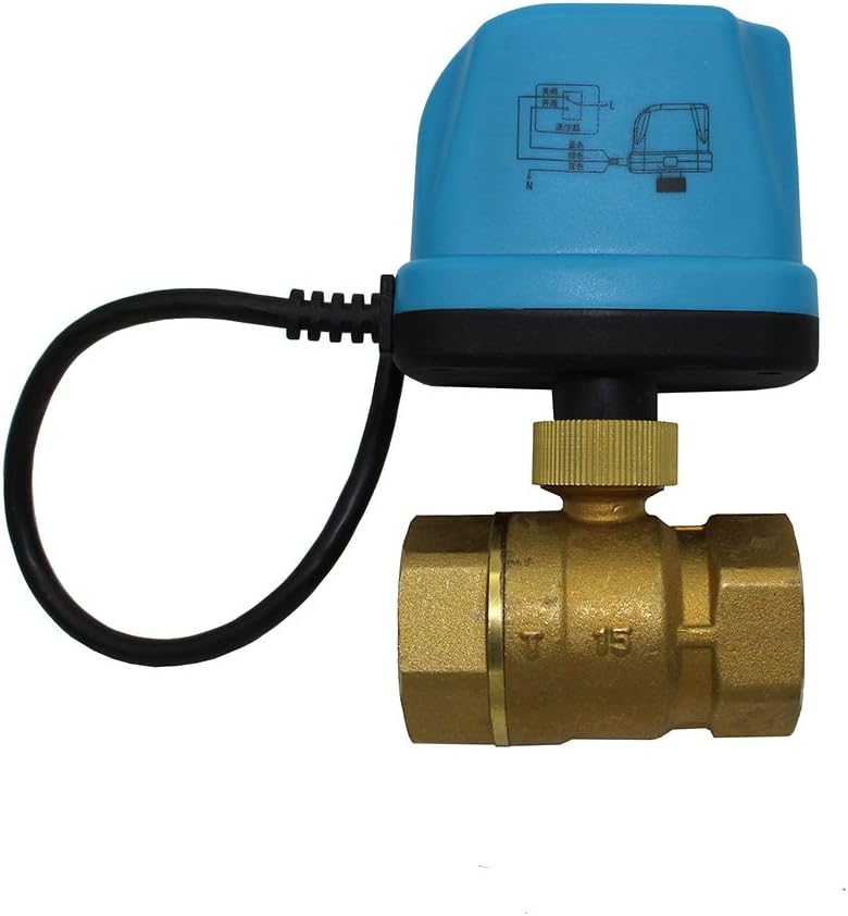

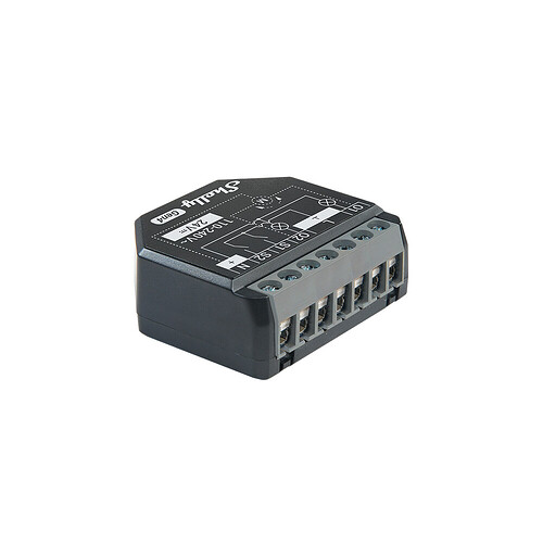

In the end I built my own, by using a 230V, 3-wire motorized valve for 25.- Euro and a Shelly 2PM (another 25.- Euro).
Works like a swiss clock - and it is fully local - no cloud or internet needed.
I run it on Wifi, but it also does BT, Zigbee and Matter.
You can do it even cheaper by using a magnet valve - but depending on your installation this may put an undue strain on your water pipes, so I wouldn't recommend that.

P.S. one question if you use the 2PM you can actually control two valves right?
These look nice but it's only wifi right? Not zigbee?
No, the 2PM is used, to make sure that you cannot send an open and close command at the same time to the valve.
You have to use the 2PM in the roller/shutter mode - basically treating the valve like a shutter.

I got it working! Thanks I would recommend people to use the solution @Frank_Beetz has given. This works like a charm.
