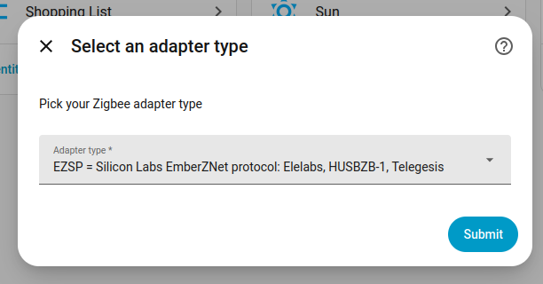

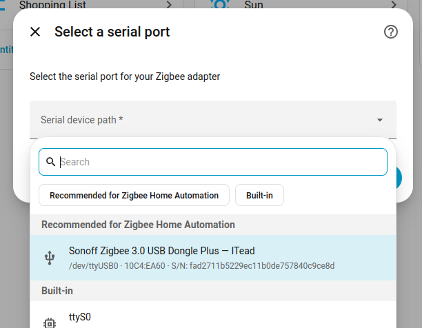

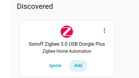

Im having issues activating the auto discovered ZHA integration when i plug in my Sonoff Zigbee 3.0 USB Dongle.
When i try to add it, it failes with:
Failed to probe the USB device

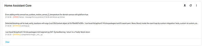

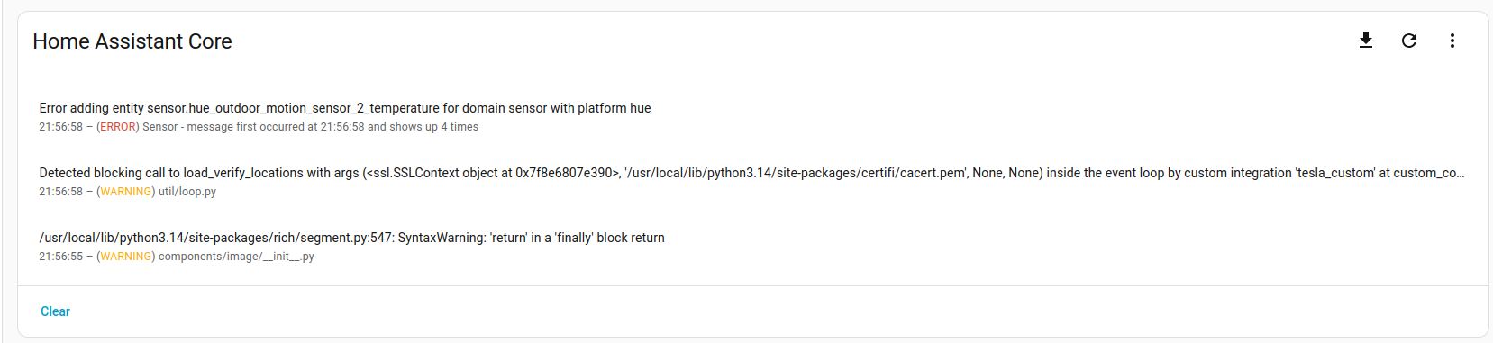

But i cannot see any relevant log entries in the Settings > System > Logs

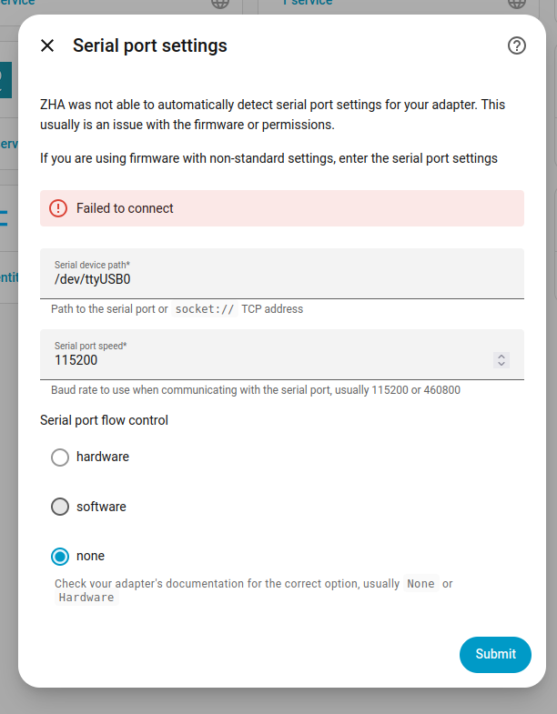

If i try to add it “manually”
It just comes as “Failed to connect”.
Still no logs.
