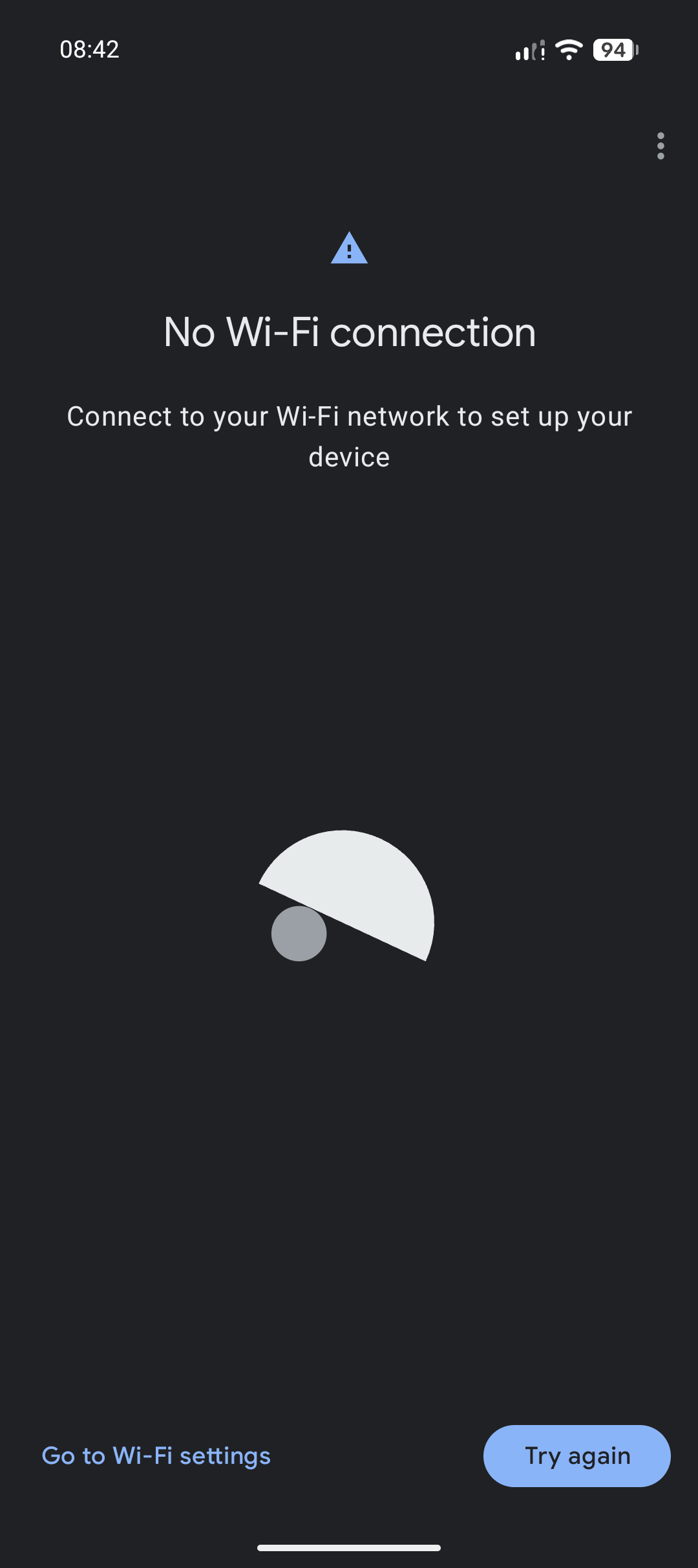

I tried setting it up with my Pixel 9A running Graphene OS.

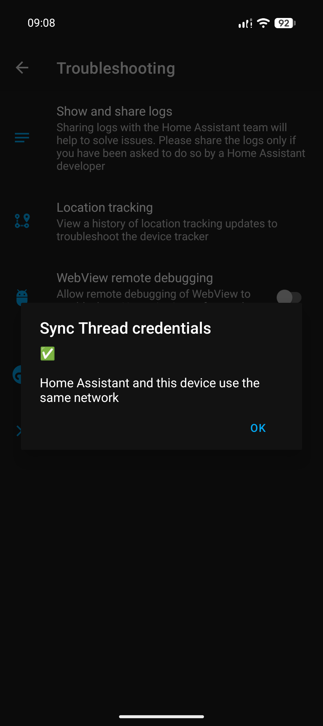

[Pic 2] ← Attached in next post to get around attachment limit.
As you can see, the device syncs threads credentials correctly. When I try to add a device, it lets me scan the QR code. But then it gets stuck at “No Wi-Fi connection”. I’ve tried giving Play Services all permissions possible and even disabled WiFi connectivity checks. Still it won’t let me get past this screen.

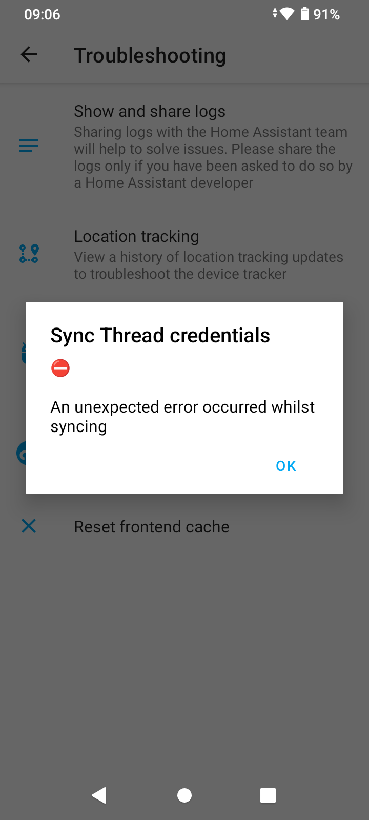

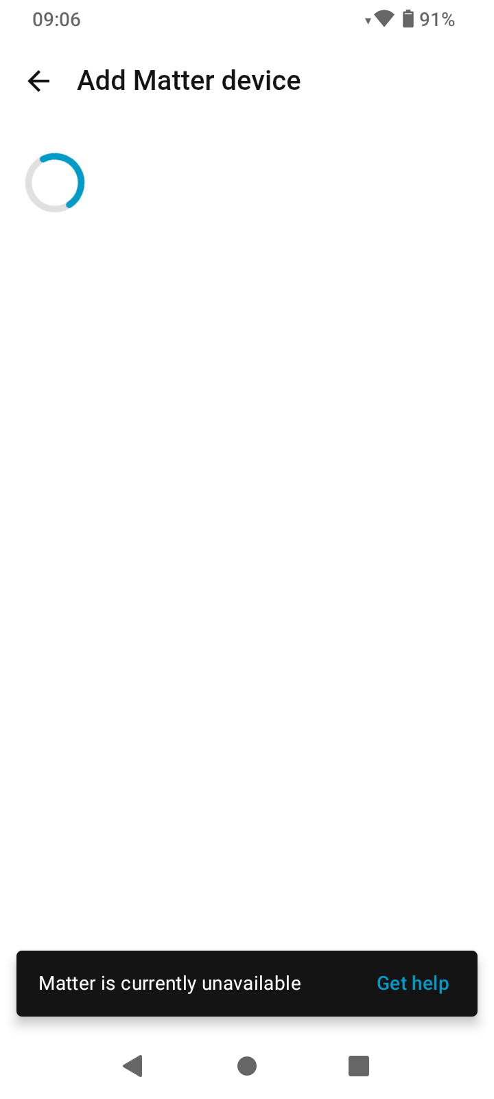

So I tried an another older phone Redmi A1 running Android 12. With this phone, I can’t seem to sync threads credentials at all and it gets stuck at “Matter is currently unavailable”.
[Pic 3] ← Attached in next post to get around attachment limit.
[Pic 4] ← Attached in next post to get around attachment limit.
