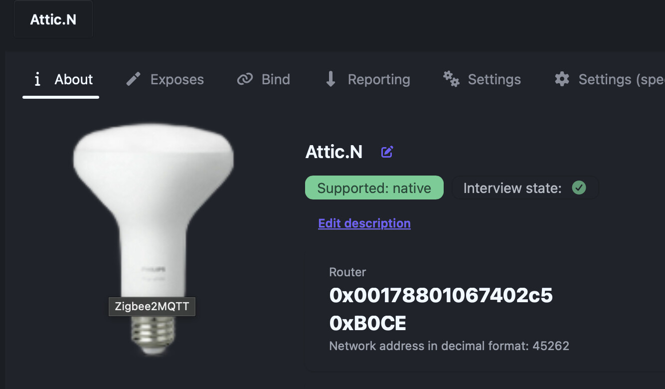

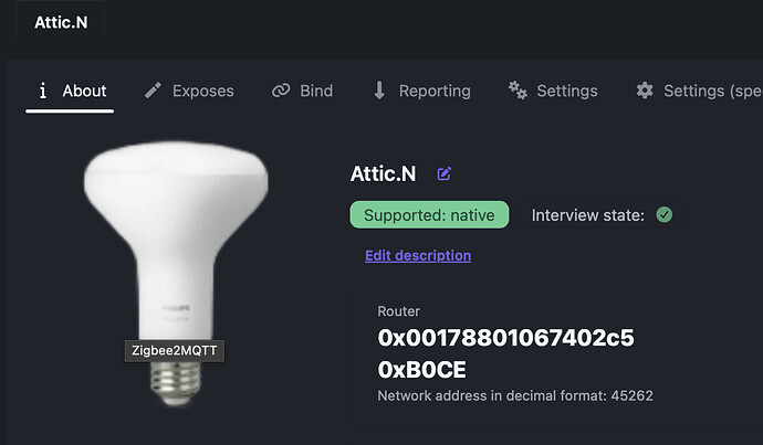

I am following your post to learn from your issue, if you don’t mind [g]. Using HA for over a year now, just moved from ZHA to Z2M. I don’t understand enough myself, but I have thoughts. . .
For point 1 & 2 (which I presume are about the same thing, I can’t read the language in the map image). . . point 2 looks like my log, ad nauseum. I thought those messages were about each device that checks in and then logs off. The 5 digits after the IP address identify a particular device. Note the fine print lower right, for the bulb below. That decimal format net.address also shown in the IEEE address column of the Z2M devices listing.

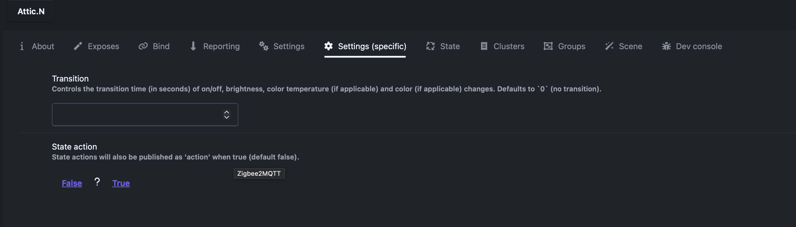

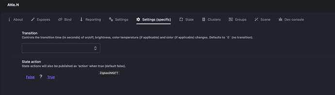

About the automation, I haven’t had such issues with Innr or Hue bulbs. Looking through the settings for a device, I don’t understand it all (yet?). But one thing that stuck out was “state action”.
If I were banging my head similarly, I’d enable that on the light bulb to see if it makes a difference for the automation. Meanwhile I hope someone with knowledge of that Z2m option would pass by and comment.

Good idea, but setting this to true did not change anything. Just tried it.
