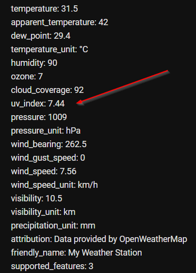

Hi everyone, (and @petro since you mentioned the ongoing transition to the modern template: structure in this thread).
I wanted to point out a bug/missing key in the schema validator for the modern template: weather integration regarding the UV index.
According to the official documentation, uv_index is an optional variable. However, when setting it up under the modern template: format, the configuration validation strictly rejects it.
Here is the modern format that FAILS:
  - weather:
      - name: "My Weather"
        temperature: "{{ states('sensor.temp') }}"
        condition: "{{ states('sensor.condition') }}"
        uv_index: "{{ states('sensor.my_uv_index') }}" # <--- This line causes the error
The Error Log:
Invalid config for 'template' at packages/weather.yaml, line xxx: 'uv_index' is an invalid option for 'template', check: weather->0->uv_index
The Workaround: If I revert back to the legacy format under the weather: domain and use uv_index_template, it works perfectly fine and parses the data correctly.
  - weather:
        uv_index_template: "{{ states('sensor.my_uv_index') }}" # <--- This works perfectly
It seems the uv_index key was accidentally left out of the schema validator when the new template: weather integration was built. Could the dev team look into adding this missing key to the schema so we can fully migrate away from the legacy _template format?

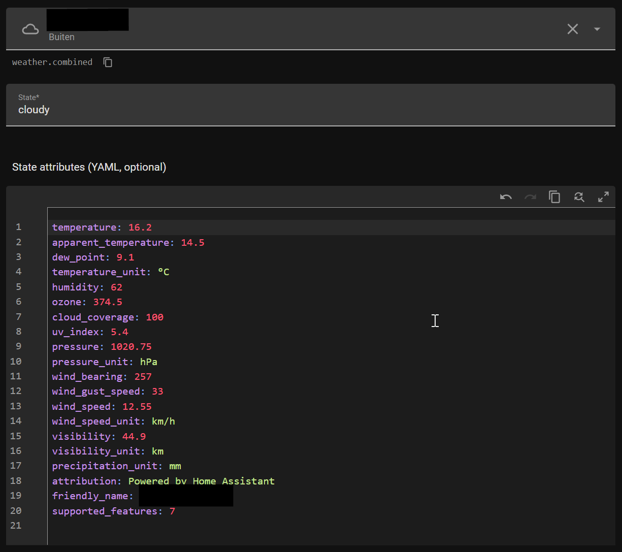

My template weather entity works fine with uv_index only in my Combined template weather
So it's strange that it doesn't for you. I added the uv_index end of March (I initially missed this option), so I has been working for me with the _template sufix since the 2026.4 beta (which I had installed end of March)
Hi, TheFes
Thanks for getting back to me! That's really strange.
I tried using just uv_index exactly as you mentioned, but it throws an error for me upon validation. Could you take a look at the attached screenshots? Do you have any idea why this might be happening, or did I format something incorrectly in my configuration?
I've attached both my code snippet and the error log for reference. Any thoughts or advice would be greatly appreciated!
I'm using Home Assistant 2026.6.2.
2026-06-11 20_26_21-EA
Really strange, for me it works with the code linked above, and this screenshot shows it works in the actual entity
