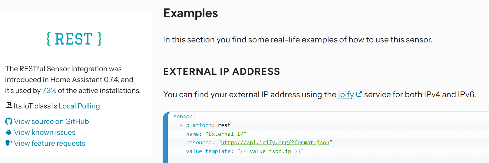

The enclosed image is copied directly from the HA Help topic: RESTful Sensor.
Here’s the actual code:
sensor:
  - platform: rest
    resource: "https://api.ipify.org/?format=json"
    value_template: "{{ value_json.ip }}"
When you enter the ip address in a browser, you get back: {"ip":"185.98.169.39"}
But when I paste this example code into the Developer tools Template Editor, it displays the result: ‘value_json’ is undefined. Shouldn’t it display the above data?
Since it doesn’t, what other coding is needed to retrieve the result from the ip address such that value_json is filled with data?
