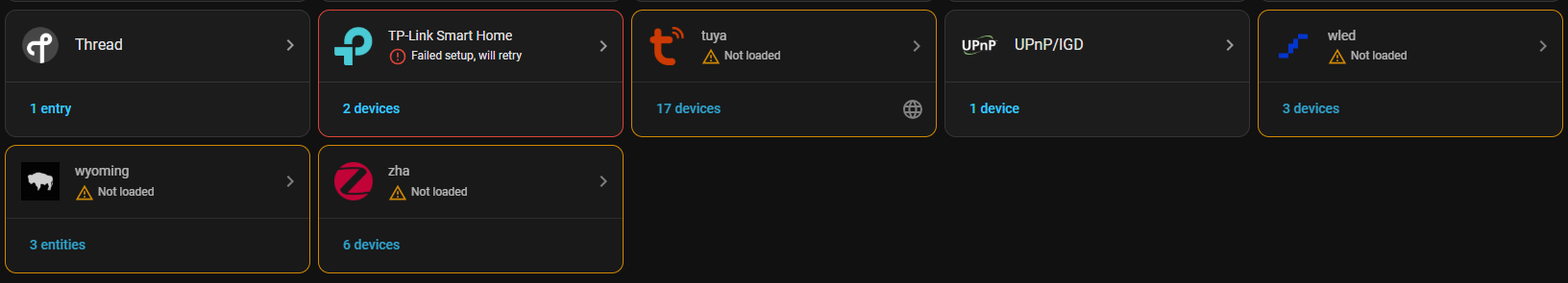

Post upgrade
Tuya and ZHA devices are not loading

Hi, did you check
Open your Home Assistant instance and show your integrations.
to see the state?
Yes, it shows not loaded
when trying to add Tuya again (without deleting exisiting)
shows : Config flow could not be loaded: 500 Internal Server Error Server got itself in trouble
