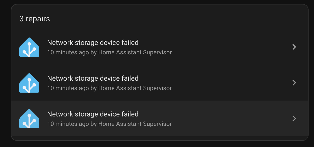

Issues with CIFS SMB 'Network' share on same computer mounting too quickly
I get these annoying repair errors on HA 17.1 2026.2.2 - which won’t be dismissed without a restart, no even ‘reload’ after resolving it doesn’t make them go away!
Looking into it it’s because HA running in Virtualbox doesn’t wait to check if the mount is available later, I get cifs_mount failed with return code -2. But then the drive DOES become available, and works fine.
Ubuntu 24.04 the host OS sees the volume fine, other computers can write to it, etc etc.

And I’ve done this in the host system now, but I suspect it won’t fix the problem cos HAOS will still boot up and try to look for that share too soon!

So is there a way of either delaying HA trying to access the Network drive on boot? Or a better way to add a CIFS Share without putting in gaping security holes or relying on a very basic add-on?
I have also tried to add the drive into a guest share in Virtualbox, that also is not seen, either mounted either in share or media. That should not have had the ‘network share delay’ issue because Ubuntu sees that natively…

I also have the same issue with , seems like 2026.2.2 broke Network storage with Samba/Windows (CIFS). Please update if you found a fix or a workaround…

Hi, so I figured out that it was a mounting problem for my SSD and restarting the server fixed the issue… Weird since Samba was sharing the mount but HASS was throwing an I/O error when trying to read from the SSD.
Yes I didn’t have problems with SMB generally, just this issue with not waiting for network discoverability or being able to dismiss the repairs. Is that a bug? I dunno.
