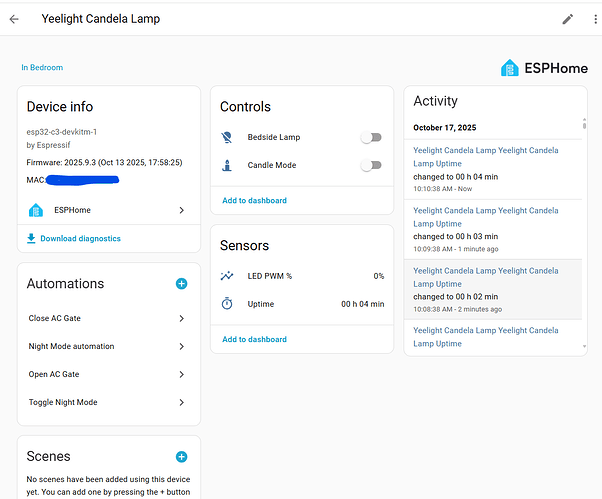

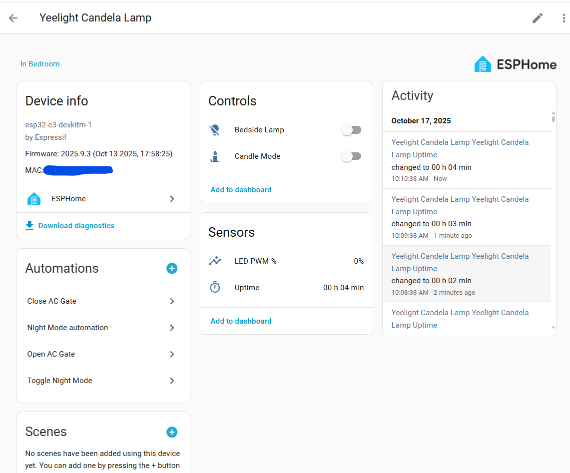

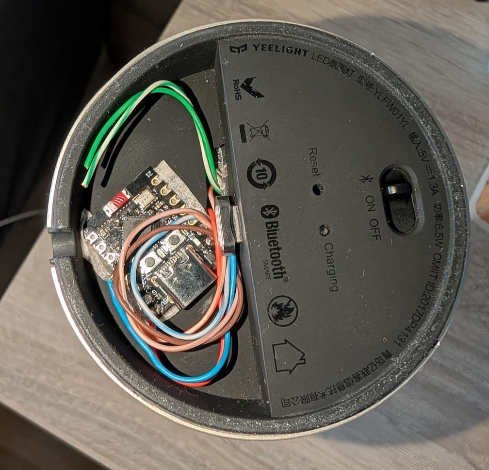

I’ve developed a custom firmware for ESP32 using ESP Home with the same functionality than the Yeelight Candela has. I am waiting for some parts so I can change my candela MCU and regain control of my candela using HA. I will post the result once it’s finished and I check everything is working as expected.
Are you willing to replace Candela MCU? You will lose every app functionality i guess but it would be great since i never used the app :slight_smile: Will you replace BT with WIfi or zigbee? Let me know! Thanks
Yes, I was able to replace the Candela MCU for an ESP32. In this case I used Wi-Fi to connect it to ESPHome.
I will make a post as soon as I have some spare time with the details and I will upload the firmware too.
It’s not hard to do it, you just have to have a cloudy day and some soldering skills.
Now, I can toggle the night mode when I turn on my Candela Lamp, or set a timer for it to fade out! :tada:

Following my previous post, I finally had some time to document the full process of replacing the original Yeelight Candela MCU with an ESP32-C3 Super Mini and integrating it with ESPHome.
A promise made is a debt unpaid.
Here it is: Replacing Yeelight Candela MCU with ESP32-C3 (ESPHome Integration)
