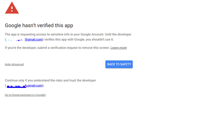

I’ve tried creating a new Published project with a new set of client secrets on Google Console, but with the same results. I’ve also tried deleting and re-creating the Google Tasks integration; this time I go through the same authentication process and get the same vague error message on a slightly different page with the error “Something went wrong. Please try again” :
Oh… and if anyone knows how to successfully verify the app with Google, please let me know. I followed the instructions to enter https://home-assistant.io as the homepage/privacy/TOS page but the verification failed, see below

I then tried opening a Home Assistant window in Incognito Mode, deleted Google Task client secret, added the Tasks integration and got to the “Google hasn’t verified this app” page, and this time it succeeded (again with a 2FA check).
