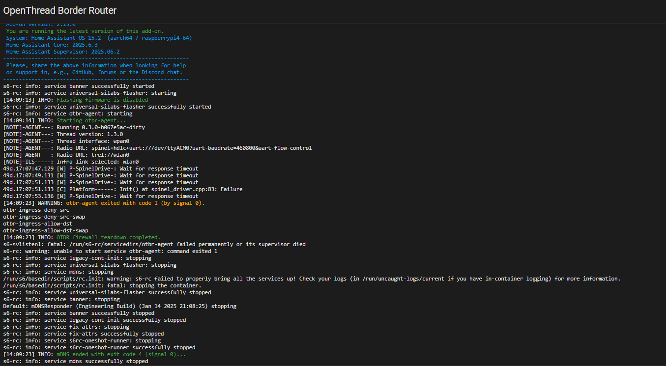

I’m having issues setting up a thread network on HA. My HA network is set up using a raspi 4 connected to a nrf52840 dk flashed with RCP firmware. I have tried several installations of the rcp firmware and still get the same issues. Any help on this is greatly appreciated. Here is the output I am getting in the openthread logs:
Sorry, I don’t know anything about this device, but clearly the ACM port is not working for the OTBR. Are there other /dev/ttyACMx devices (i.e OTBR is connected to the wrong ACMx)?

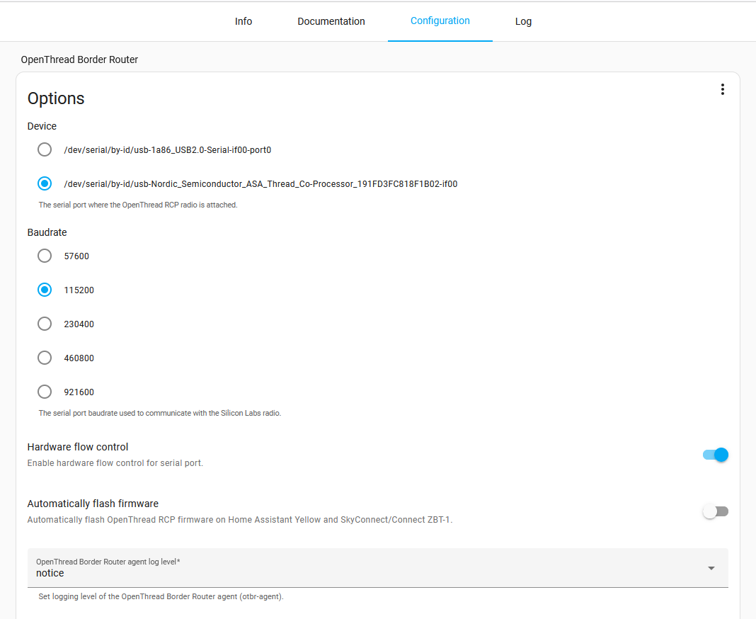

These are my settings:

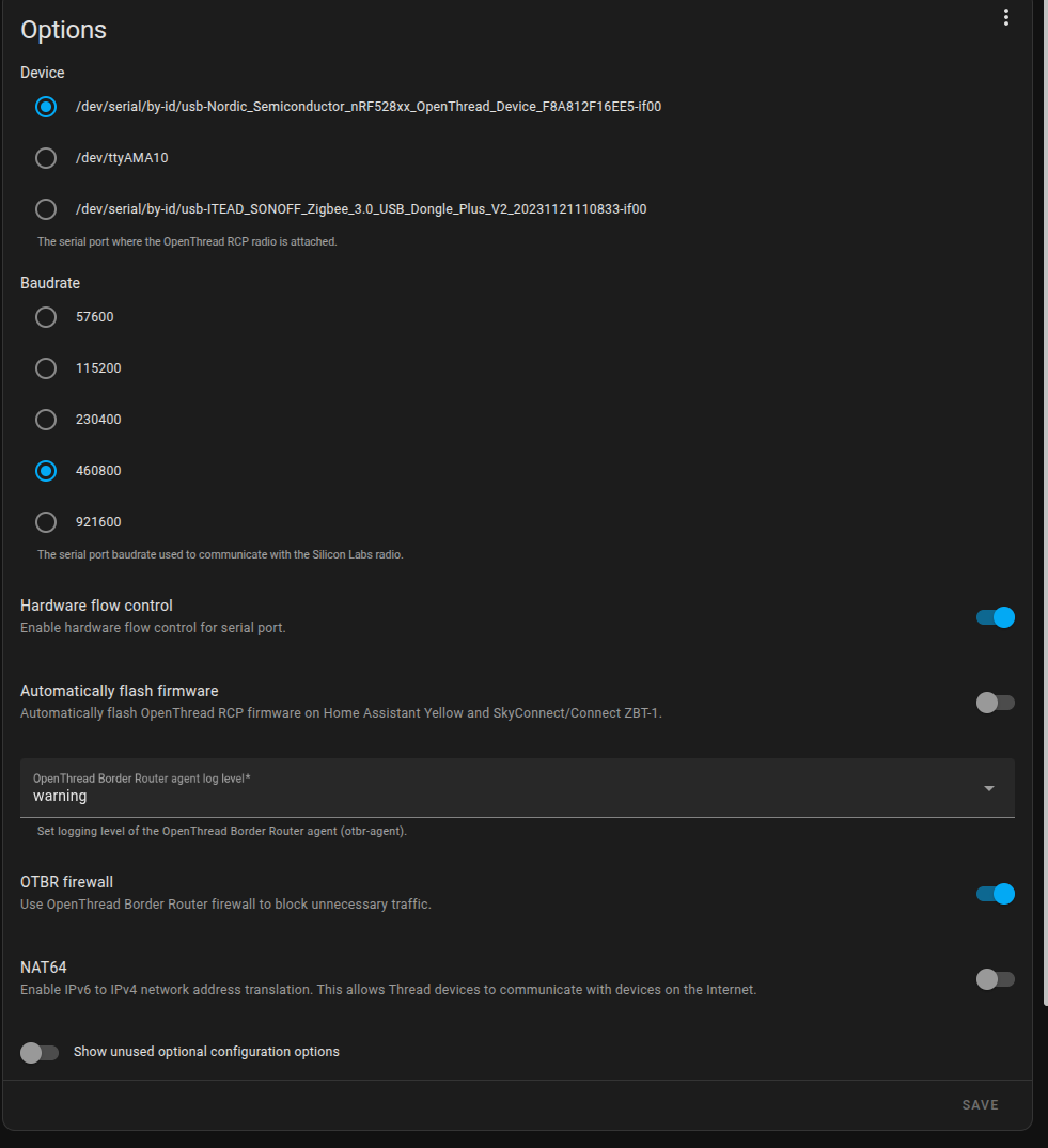

these settings work in my thread network.
