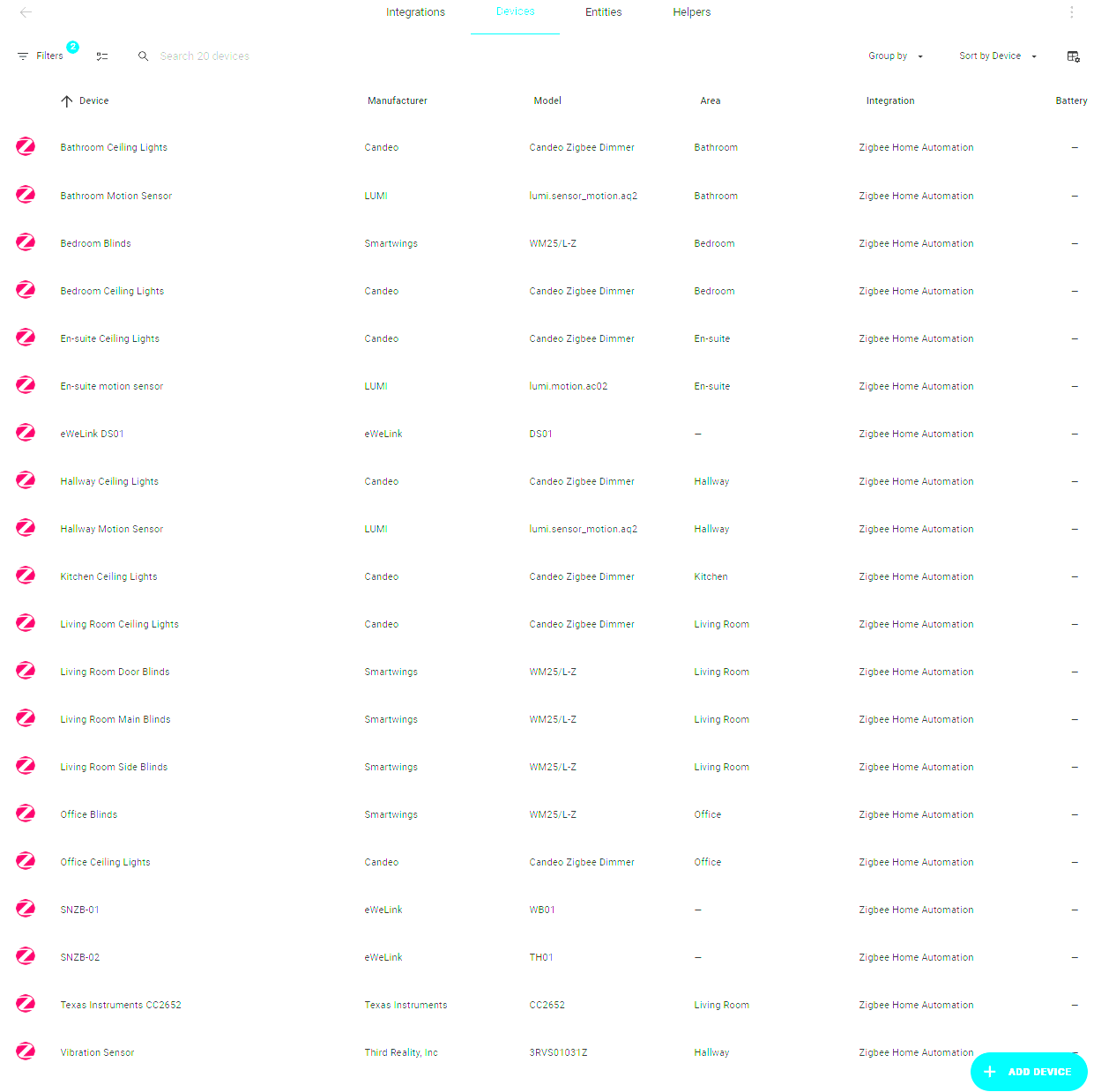

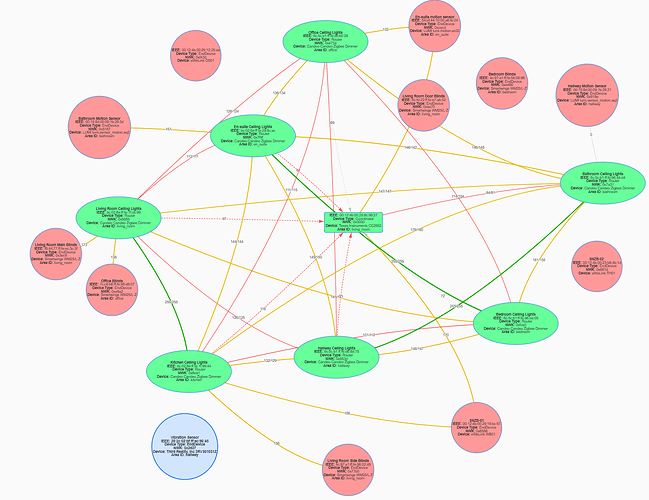

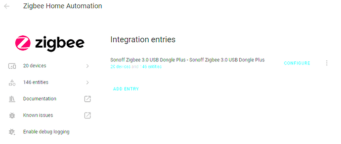

Hi Jack!
Here are some images of the zigbee devices, integration home and the network:
From the network it would appear I have 12 end devices and 7 routers as well as the coordinator.

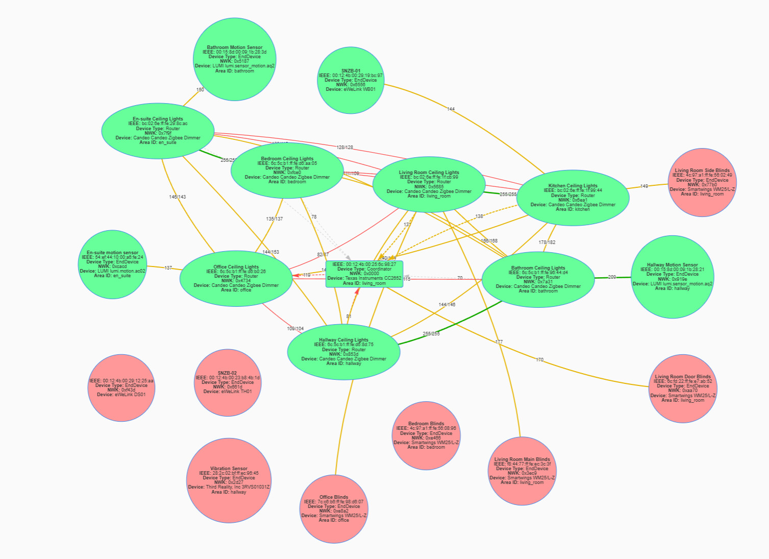

I am still seeing my blinds go unavailable despite the change. See the network image below:
The blinds without a line could do with a router nearby.
