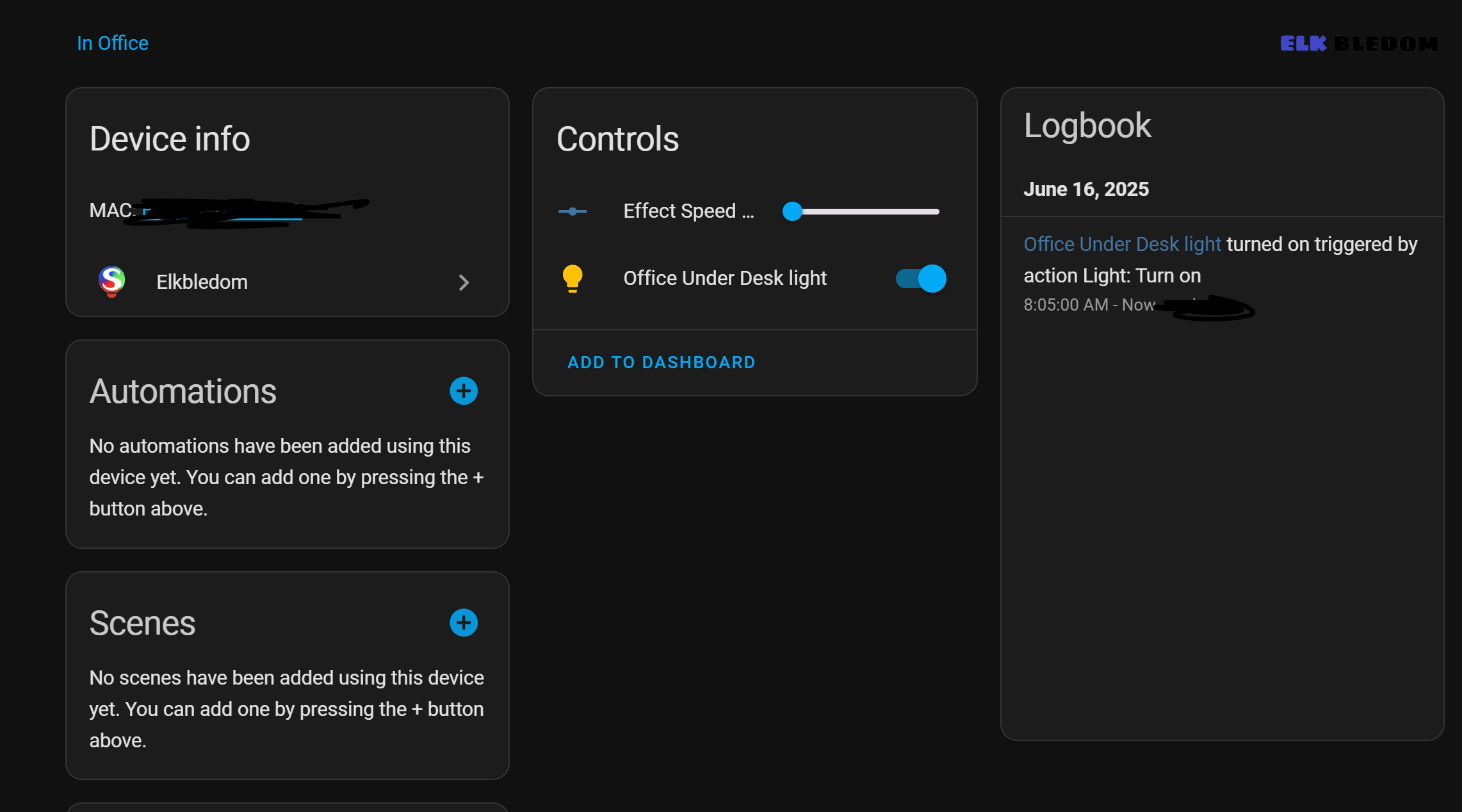

Well, i did a quick search and found how to do that. its pretty simple since there’s already one integration that supports these lights. Only thing you’ll need is the bluetooth integration; i have 2 ESP32 bluetooth proxy (but not required) or bluetooth support on your instance.
Then i went to HACS and installed this repo : GitHub - dave-code-ruiz/elkbledom: Home Assistant custom component for LED STRIP NAME ELK BLEDOM
My light was automatically discovered.
Give it a try !

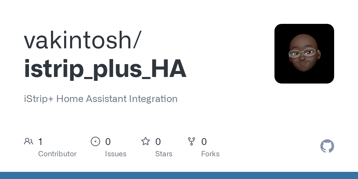

I’m currently developing a Home Assistant integration for iStrip+. It’s still a work in progress, but I’ve made solid progress so far.
