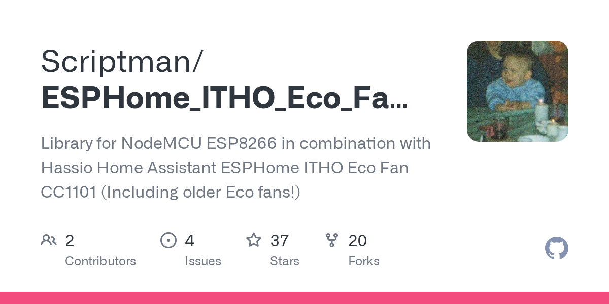

Hi All,
My ITHO is running on ESPhome 2024.8.3 with a library:
This cannot be update to ESPHome 2025.9.x:
INFO ESPHome 2025.9.3
INFO Reading configuration /config/esphome/meek-itho.yaml...
Failed config
esphome: [source /config/esphome/meek-itho.yaml:13]
  Please remove the `platform` key from the [esphome] block and use the correct platform component. This style of configuration has now been removed.
  platform: ESP8266
  board: nodemcuv2
  includes:
    - lib/scriptman.h
  libraries:
    - SPI
    - Ticker
    - https://github.com/Scriptman/ESPHome_ITHO_Eco_Fan_CC1101.git
  on_boot:
    then:
      - lambda: |-
Does someone have a different library or total different way how to solve this?
