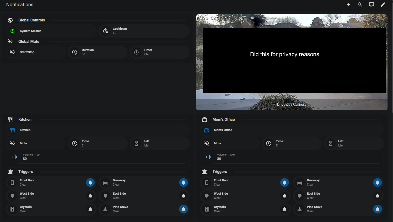

So the image is of a dashboard for a system I’ve been working on for a while. Basically my dad has a bunch of outdoor sensors that triggers when someone comes on the prosperity. There is 6 sensors for this. It seems like it is overkill but my sister has ties with very bad people, and she isn’t a good person. Also a year or 2 ago some people did try to break into our property. They left quickly.

Anyways, now due to this I can do 2 things.
  1. The alerts over google home speakers
  2. Automations
When given sensors trigger the outside lights turn on 100% for 15 minutes. This is a straight forward motion then trigger thing.
But the sound was/is a bit of a nightmare.
During testing I found there is no way to group all the Google Home speakers and ungroup with code. I tried this to prevent the popcorn thing but ya…
I’m still modifying things and if you find things then let me know. Because I’m doing this on my own and it is extremely complex ya…
But with the sound the rules are simple.
Global timer is used to prevent multiple sounds from playing ontop of each other. Global sound can be edited by the user in the Driveway Alarm dashbaord
Sensor timers are used for when the global timer is active, so sensors don’t spam the system. Basically, if the sensor timer is idle, then it adds the sensor to the list and start the timer. If the sensor triggers again during that time, it doesn’t itslef to the list
The system should respect the mute decitions made in the dashbaord.
The system should adjust the sound after saving it per speaker before playing. This allowing the alarm to be heard but sound to be restored. Sound is set on the dashbaord.
How it works or should work is like this
Trigger happens, it starts the sensor and global cooldown timer and does sound. If another sensor triggers in the time for the global cooldown then it gets added to a text list to play right after, if it triggers multiple times then it ignores it which is why every sensor has their own cooldown. Then if another triggers it gets added.
When the global cooldown gets done it looks at the next thing on the list and pushes that alert out, start the global cooldown, and repeat until the list has nothing on it. If a given sensor is muted on all speakers then it just bypasses that and moves to the next thing on the list so there is no wait.

                          media_content_id: "{{ mp3_map[check_id] }}"
                          media_content_type: audio/mpeg
                          metadata: {}
          - alias: Log Outcome
            action: logbook.log
              name: Driveway Announcer
              message: >-
                Processed queue item {{ check_id }}. Result: {% if should_play
                %}Played Audio{% else %}Skipped (Muted/Suppressed){% endif %}.
                Reason: Global Timer Finished.
mode: parallel
max: 20
variables:
  sensor_map:
    binary_sensor.front_door: front_door
    binary_sensor.front_door_to_outside: front_door
    binary_sensor.wyze_cam_front_porch_camera_motion: front_door
    binary_sensor.driveway_alarm: driveway
    binary_sensor.east_side_yard: east_side
    binary_sensor.side_yard_next_to_driveway: west_side
    binary_sensor.crystal_s_driveway: crystal
    binary_sensor.pine_grove: pine_grove
  trigger_id: "{{ sensor_map.get(trigger.entity_id, 'test') }}"
  individual_timer_entity: timer.cooldown_{{ trigger_id }}
  is_individual_cooling: "{{ is_state(individual_timer_entity, 'active') }}"
  mp3_map:
    front_door: media-source://media_source/mp3/Front_door_Alarm.mp3
    driveway: media-source://media_source/mp3/Driveway.mp3
    east_side: media-source://media_source/mp3/East_yard.mp3
    west_side: media-source://media_source/mp3/West_side.mp3
    crystal: media-source://media_source/mp3/Crystal_driveway.mp3
    pine_grove: media-source://media_source/mp3/Pine.mp3
    test: media-source://media_source/mp3/Driveway.mp3
  speaker_list:
    - player: media_player.mom_s_office_mini
      bool_prefix: input_boolean.notify_mom_office_
      vol_storage: input_number.mom_s_office_volume
      vol_target: input_text.mom_s_office_alert_volume
    - player: media_player.game_room_speaker
      bool_prefix: input_boolean.notify_middle_room_
      vol_storage: input_number.middle_room_volume
      vol_target: input_text.middle_room_alert_volume
    - player: media_player.kitchen_display
      bool_prefix: input_boolean.notify_kitchen_
      vol_storage: input_number.kitchen_display_volume
      vol_target: input_text.kitchen_alert_volume
    - player: media_player.master_bedroom_speaker
      bool_prefix: input_boolean.notify_master_bedroom_
      vol_storage: input_number.master_bedroom_volume
      vol_target: input_text.master_bedroom_alert_volume
    - player: media_player.my_bedroom_mini
      bool_prefix: input_boolean.notify_my_bedroom_
      vol_storage: input_number.my_bedroom_mini_volume
      vol_target: input_text.my_bedroom_alert_volume
    - player: media_player.kid_speaker
      bool_prefix: input_boolean.notify_kids_room_
      vol_storage: input_number.kids_room_volume
      vol_target: input_text.kid_alert_volume
System wide mute logic
alias: Driveway - System Wide Mute Logic
description: >-
  Handles the GLOBAL mute button. Snapshots ALL rooms, turns ALL rooms off, and
  restores ALL rooms.
triggers:
  - trigger: state
    entity_id: input_button.mute_global
  - trigger: event
    event_type: timer.finished
    event_data:
      entity_id: timer.global_mute
actions:
  - variables:
      target_timer: timer.global_mute
      target_scene: scene.before_mute_global
      target_text: input_text.mute_text_global
      all_entities:
        - input_boolean.notify_mom_office
        - input_boolean.notify_kitchen
        - input_boolean.notify_middle_room
        - input_boolean.notify_my_bedroom
        - input_boolean.notify_master_bedroom
        - input_boolean.notify_kids_room
  - choose:
      - conditions:
          - condition: trigger
        sequence:
          - choose:
              - conditions:
                  - condition: template
                    value_template: "{{ is_state(target_timer, 'active') }}"
                sequence:
                  - action: timer.cancel
                      entity_id: "{{ target_timer }}"
                  - action: scene.turn_on
                      entity_id: "{{ target_scene }}"
              - conditions:
                    value_template: "{{ is_state(target_timer, 'idle') }}"
                sequence:
                  - action: scene.create
                      scene_id: "{{ target_scene.replace('scene.', '') }}"
                      snapshot_entities: "{{ all_entities }}"
                  - action: input_boolean.turn_off
                      entity_id: "{{ all_entities }}"
                  - action: timer.start
                      duration: "{{ (states(target_text) | float(0) * 60) | int }}"
      - conditions:
        sequence:
mode: single
The sync for the switches.
I had to make this because I wanted master controls on the dashboard.
alias: Driveway Smart Switch Sync
description: Cascades master switches to sub-switches and updates master status.
triggers:
  - trigger: state
    entity_id: input_boolean.driveway_system_master
  - trigger: state
    entity_id:
actions:
  - choose:
      - conditions:
        sequence:
          - action: >-
              input_boolean.turn_{{
              states('input_boolean.driveway_system_master') }}
              entity_id:
      - conditions:
        sequence:
          - variables:
              new_state: "{{ states(trigger.entity_id) }}"
          - action: input_boolean.turn_{{ new_state }}
              entity_id: >
                {{ trigger.entity_id }}_front_door, {{ trigger.entity_id
                }}_driveway, {{ trigger.entity_id }}_east_side, {{
                trigger.entity_id }}_west_side, {{ trigger.entity_id }}_crystal,
                {{ trigger.entity_id }}_pine_grove
mode: parallel
Sun glare rule
I made this because I thought sun was triggering one of the sensors and it turns it off during that time.
alias: "Solar Glare: East Side Mute & Restore"
description: >-
  Snapshots East Side alerts, turns them off during sun glare (Azimuth 100-135,
  Elevation < 30), and restores them afterwards.
triggers:
  - entity_id: sun.sun
    attribute: azimuth
    trigger: state
actions:
  - variables:
      is_glare_zone: |
        {{ 100 <= state_attr('sun.sun', 'azimuth') <= 135 and
           0 <= state_attr('sun.sun', 'elevation') <= 30 }}
      target_entities:
        - input_boolean.notify_mom_office_east_side
        - input_boolean.notify_kitchen_east_side
        - input_boolean.notify_middle_room_east_side
        - input_boolean.notify_my_bedroom_east_side
        - input_boolean.notify_master_bedroom_east_side
        - input_boolean.notify_kids_room_east_side
  - choose:
      - conditions:
            value_template: "{{ is_glare_zone }}"
            value_template: >-
              {{ states('scene.east_side_sun_snapshot') in ['unknown',
              'unavailable'] }}
        sequence:
          - data:
              scene_id: east_side_sun_snapshot
              snapshot_entities: "{{ target_entities }}"
          - target:
              entity_id: "{{ target_entities }}"
      - conditions:
            value_template: "{{ not is_glare_zone }}"
            value_template: >-
              {{ states('scene.east_side_sun_snapshot') not in ['unknown',
              'unavailable'] }}
        sequence:
          - target:
              entity_id: scene.east_side_sun_snapshot
