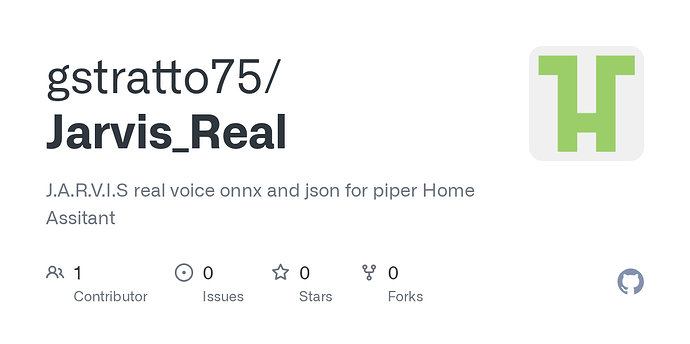

Update, tried to update them to github but it says 25mb limit. any other suggestions on how i can share? I dont want to violate any terms.
ok figured it out here are the files. Enjoy.
