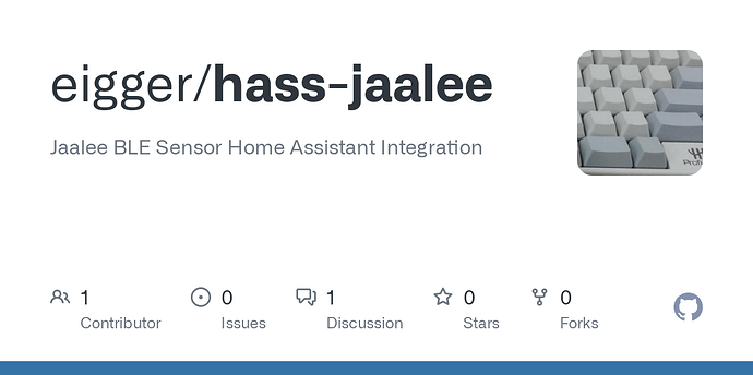

Edit:
Added HA Custom Intergration

Previously, this wasn’t supported, but now it supports not only ESPHome sensors but also HA custom integrations. When HA detects a sensor, it is automatically registered.

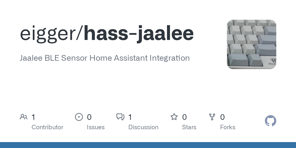

@eigger I didn’t notice or get notified about your custom_component that does actually the same
